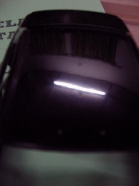

Before
We can see that the paint is uneven right ? Don't worry.....After that ,wetsand with 1200 gritt, followed by 1500 grit, and lastly 2000 grit. You will feel it smooth.Let it dry....

The result

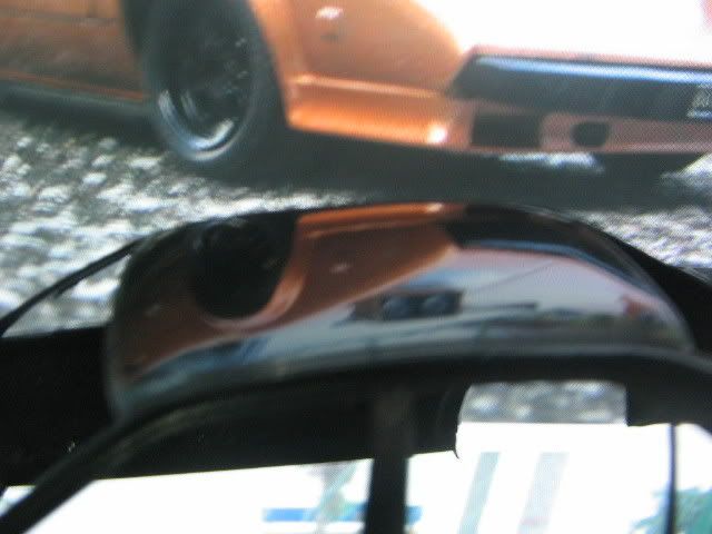

Next, use a fine cloth and use some polish cream and polish the model. Do it in circular motion till you get the shine like below....

Not very good photos quality though...
Cham, the 1200,1500 and 2000gritt sand paper can be bought from hardware shop ? need to wet the surface 1st before sanding right ? Also wont the paint get sand off ?what paint you are using in the pic ? Tamiya or hardware paint? how much pressure you apply to the sanding surface ? very strong or medium only.
The polish you use is those normal car polish or what ?? I can see the result is very shinny and smooth.

yes
TitanReeve,
I use from those sandpaper that are from Tamiya or from hardware shop...
And i using SOFT99 polish cream and normal polishin clothes...
