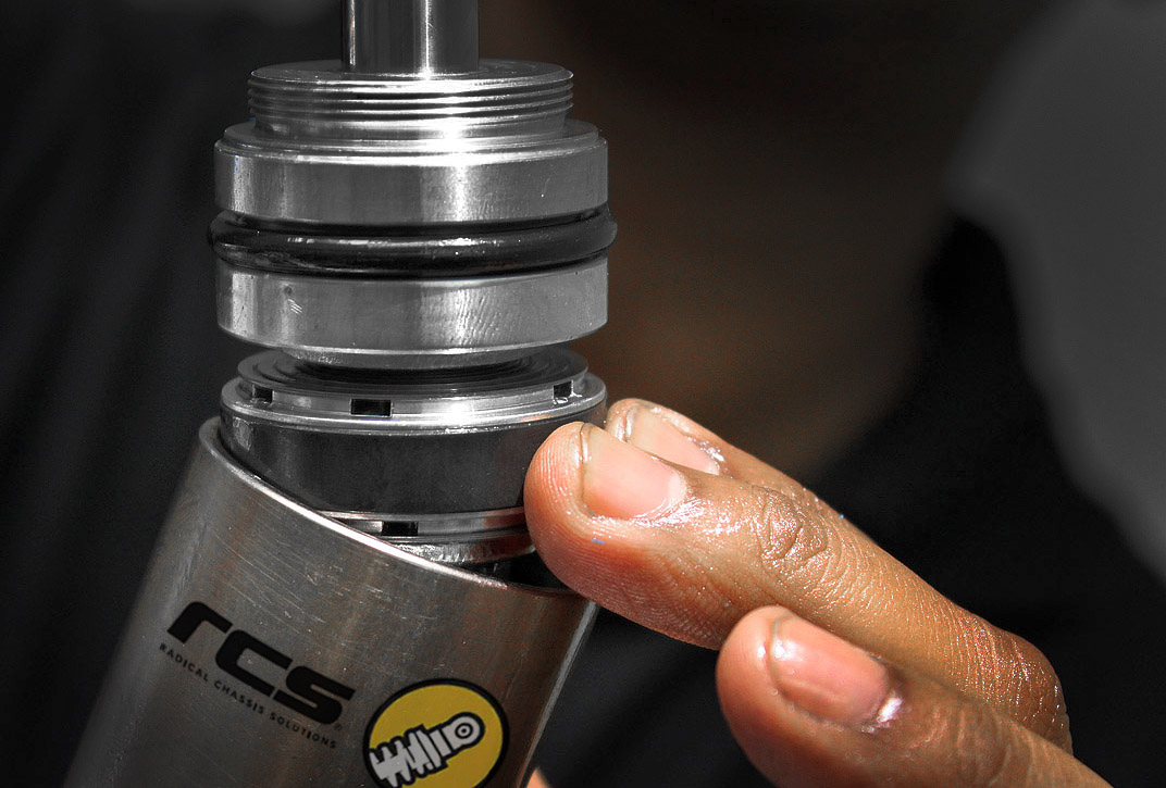

Velocity Sensitive Damping working pistons Designed and Manufactured in Malaysia by Nanda.
If RCS's race experience and unique tools aren't enough' to convince you, then their house specialty just might. The heart of a well designed coilover is in it's shock absorber. What makes it tick is in the working piston. Other suspension builders take the easy way out by utilizing commonly available suspension designs and internals, be it the twin-tube or stronger inverted monotube to the all-important working piston and shims.
Nanda & Clayton pulling dampers apart for re-valving.
The RCS difference lies in its Velocity Sensitive damper that magically adjusts itself to the ever changing road conditions and speed in which the car is traveling. I shall not go into the detailed science of it but it is mostly in the working piston feature. Other piston designs are mostly passive, meaning a set bound and rebound no matter the scenario.
The shims are like a valve that governs fluid flow amount through the working piston.
Where RCS's velocity sensitive piston comes in is its ability, through fluid dynamics to provide a supple, comfortable glide through harsh terrains and sharp bumps and humps, yet in microseconds, firm up for that anti-roll, 90 degree or high-speed corner. A good example of this similar application is RenaultSport's derived hot hatches. If you had the privilege of driving the latest Renault Megane RS 250, or its recent RenaultSport siblings, you'd know the confidence in speed and road holding it inspires. It almost feels unreal.
