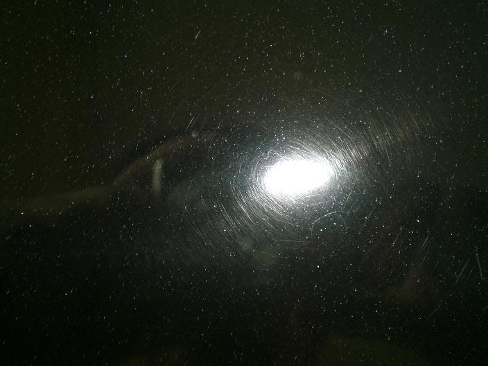

Before treatment:
Swirls, swirls and more swirls!
After washing the car at a snow wash service, I clayed the car. I can really feel the paint getting smoother after rubbing the clay over the surface and lubricating it with the Quik Detailer.

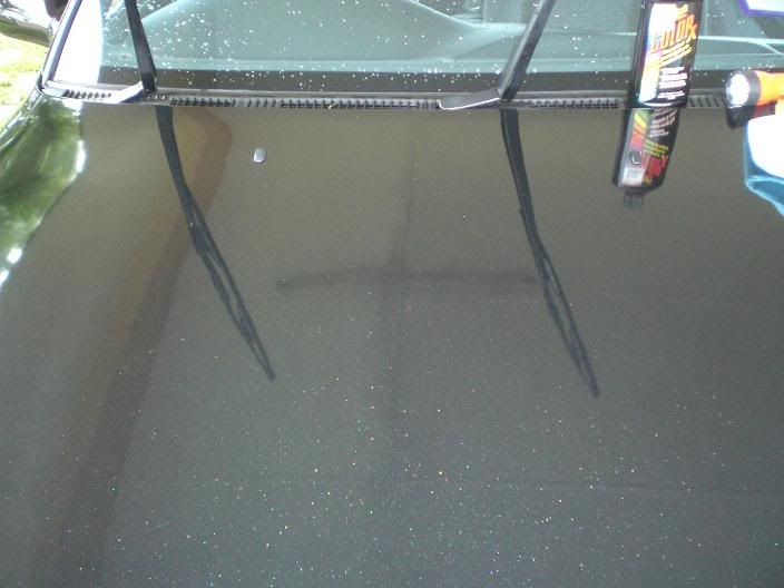

After claying, I went on with the ColourX.
Left side is untreated. As you can see, the colour on the right is richer and darker.

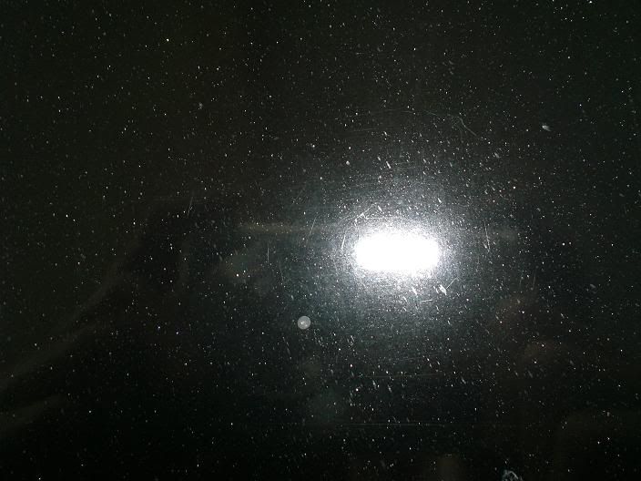

After treatment:
Swirls are less visible after polishing. But, some major scratches were still visible under a strong light.

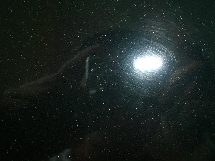

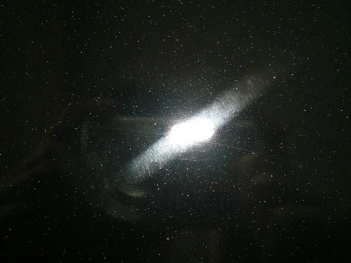

However, the large scratch on the trunk was almost eliminated. Before this, it was really visible but now, if you don't purposely look for it, you can't find it. I was really impressed at this. Unfortunately I didn't have time to take some proper pictures.
Before
After

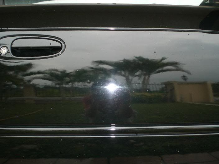

Final results:
"Stop looking at the other car and get back to work!"
Good reflection all round
The hood looks the best.
I'm really impressed with ColourX and NXT Tech Wax because they really do show a difference on the paint surface. The result is not stunning but it's certainly impressive. Maybe my technique is wrong.

here's my little comment..just my 2 cents.
ColorX work more like color restorer more then swirl remover..
ScratchX is swirl remove
But both of them are abbrasive....ScratchX more then ColorX
Looking at ur pic i do feel ur car paint, paint job is not so good quality...even u clay, colorx and wax but the deep dark shin is not there...can see it clearly from the reflection at the car doors
No offence

Haha I was thinking the same thing too. The paint job was done by the previous owner 3 months before he sold the car to my bro. So, I don't know the quality of the paintjob but overall, it looks better than a really botched up paintjob I've seen on my friend's car.
The reason I chose ColourX is because I wanted to polish the car, but I didn't want to get a polisher and a scratch remover as it will be out of my budget. So I opted for a compromise. Trust me, when I get my ROB, I'll be using ScratchX.
