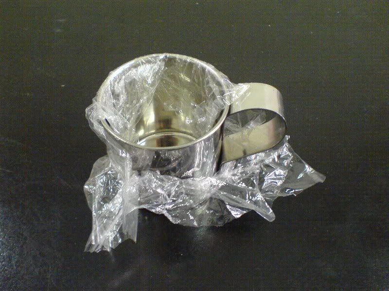

Agree bro, the mug only RM2.50 and can be removed easily. Your S flow how many inches inlet?

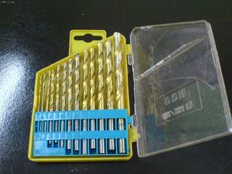

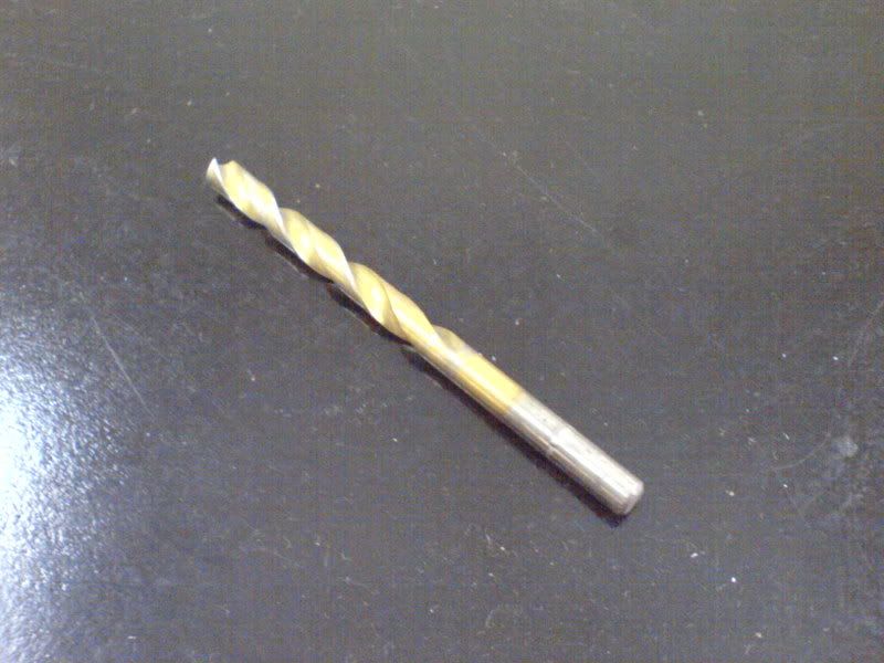

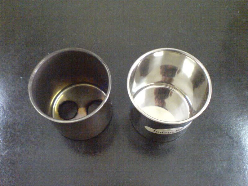

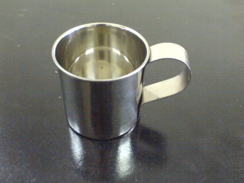

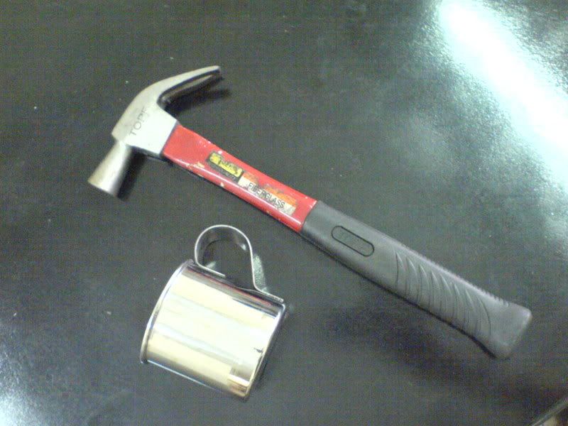

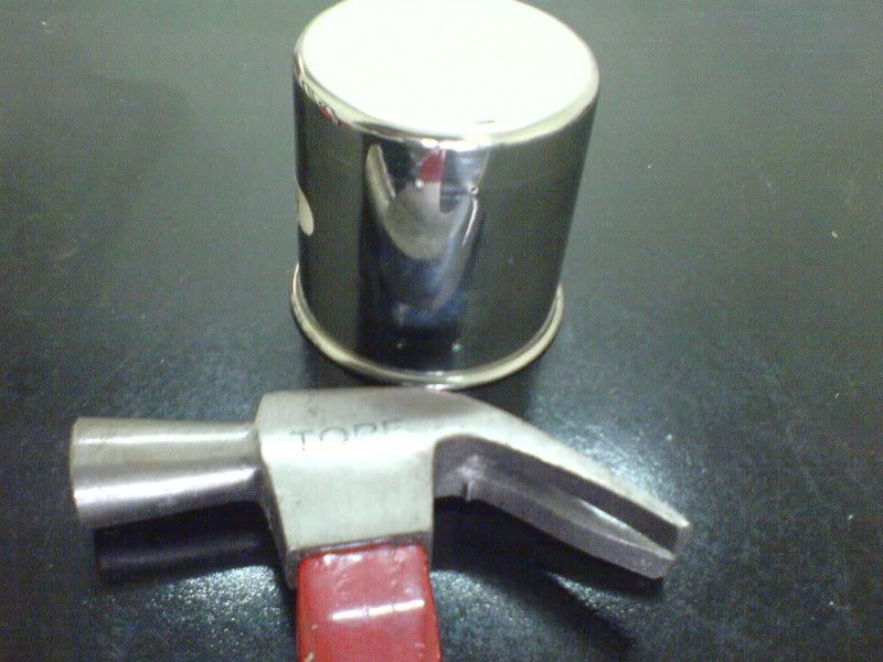

I got my mug at the same place at the same price and same process again. This time, small holes will be driven instead of big ones.

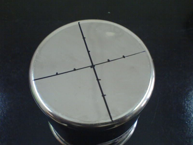

After calculations, i have to drill 8 holes with 6mm drill bit. Which is the same area with a 2 inches hole.
Mark and drill~

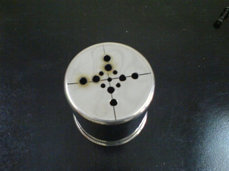

I tried it out when it was 8 hole. I found out that the back pressure high. I can feel the exhaust gas pushing my mug out and of course it is quiet. So, i drill 5 more smaller holes hoping it would reduce the back pressure a little.

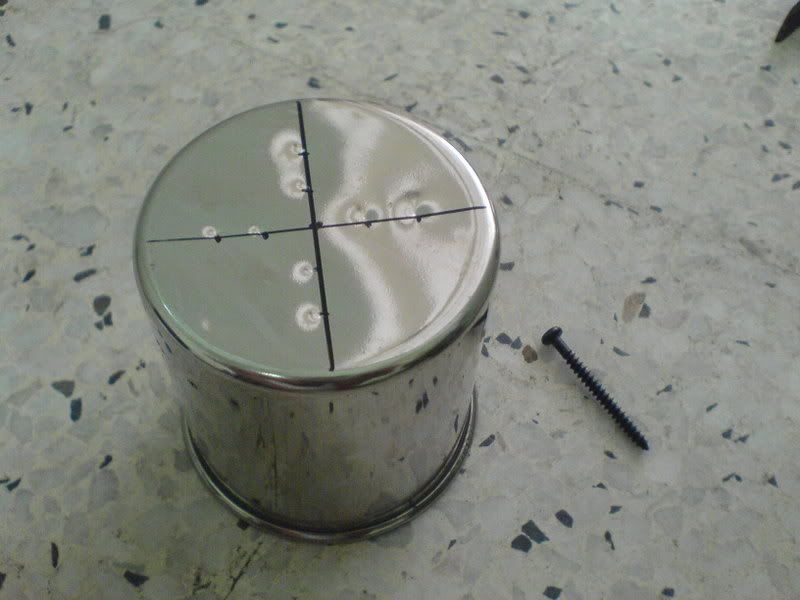

New technique.
Drill sufficient holes to suite your taste.
The process will be DRILL --> TEST --> DRILL --> TEST until you are satisfied.

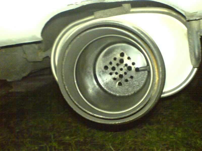

After all those test and drills, i end up like this.
I am satisfied with this setup. The LMST big exhaust is louder than mine. :banghead:
Power wise, dropped dramatically. :banghead: Use until bo syiok only take out. :slug:
ur this setup blocks a lot of the muffler tip mouth. i think ur previous setup with 2 big hole looks better than this setup. this setup sure give u a lot back pressure. FC wise got improve??

Ya bro, high back pressure. I am not sure about the FC but car moves like turtle. I am testing it right now. :listen:
hahaha... no need silencer lah... u power freak dun induce so much backpressure... ur turbo need to push out air as fast as possible so can boost properly.... kekekeke...
