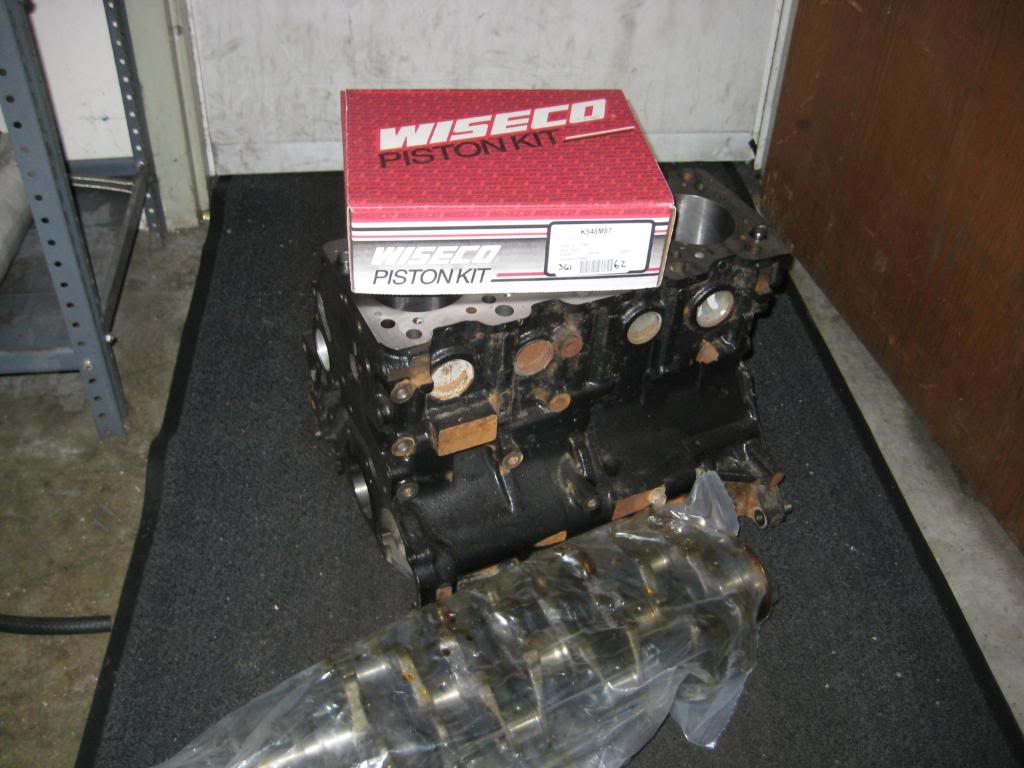

currently think of stroke up my evo 4 4g63 engine with 4g64 2.4L grandis block, but my mech ask me to hold on,wait for confirmation until people prove that the block can be use, my mech told me , he suspect that the starter position is different from 4g63,4g63 is at btm part of the block, but 4g64 starter position is near middle, if just put in the block will resulting in starter being block and heat up by the turbo.... any evo sifu had done this successful?i know evo 1-3 can but how about 4 and above?? i appreciate helps :bawling: our brother in ZTH Mr.xtreameleo still waiting my answer on the block... pls help is any sifu know about this... :adore::adore::adore:

still waiting the pix for dis engine block, i also havent done dis mod on the later evo sirs (new gen), a noob in this also.. what ive gathered so far, is just like what peter stated, the starter is going to interfere with the turbine, from what i heard a lil but u wudnt want info like "a lil" if the block u source out came from across the sea.. anybody with a solid proof, maybe a pix on the placement of the starter, to speed things up?
if i was u, i will put in the 4g64 crank into the 4g63 n call it a day,
it has been proven tht u can rev higher a lil than pure 4g64 due to lighter short skirt stroker pistons
bt of cos , if u r heading this way, its gonna be forged all in
what is mean?:banghead::confused: but from wht i c on net, really got ppl done it...... but i m still confuse with 4g64 and 4g69, 4g69 from grandis and 4g64 american claim it is from galant, it is what i heard from galant forum, both 4g64 and 4g69 are 2.4L , dunno which is correct to sumbat.... like the ipoh town iklan... "so...many choices ,how to choose?:biggrin:" but i prefer choose correctly, if it is sure can be done, i will go for the torque monster, if not sure, better just overhaul my current engine :bawling::bawling: i think head gasket blown already, coolant change in condition,bit dark and unclear...:bawling:

it is 2.4L le..... lol ..... 4g64 for e3 is easy to source and ppl done it, for e4 onwards, so far din heard ppl here done it, only ppl oversea done it, even sifu xtreameleo also dunno

got oil leaking, suspect head gasket blown, + last time this engine blown by japan guy cause hitting the filter and break,timing belt got damaged but lucky no valve damaged, spin use hand still very tight, no sound of valve hitting and compression loose, i machine back the place where filter being screwed...remove balancing shaft,change new bearing for one of the worn shaft(dunno wat part inside block),new belt and run till now....... actually i can just get rid the oil leak maybe just replace he gasket but i wan thing perfect and less hassle , so just do full overhaul,at least i know things are new inside as sifu xtremeleo told me and it can last me few more years without scare of the old internal part leak again and bring me problem.....
if i not wrong no nid rebore, ori bore size is 87 mm, stroke is 100mm

from the info i gathered last time when i was thinking of stroking my e3 i found out that the 64 has a bore size of 86.5mm exactly
u can google it as well just to make sure
