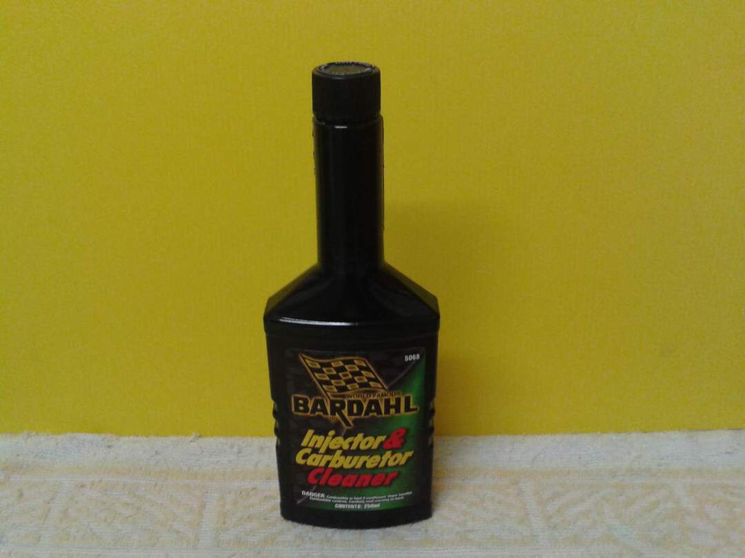

Last Thursday, I poured Bardahl Injector Cleaner in the fuel tank. Since then the car does not jerk anymore. The rhythm of the engine sounds smooth, back to normal as it used to be. Could it be that the Injector cleaner has helped to solve the problem? I don't know but I will observe the situation for a few days more.
Weird. Injectors clogged should affect you throughout the rev range, not just at idle.
