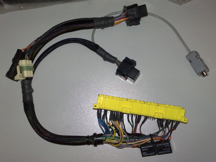

Haltech Platinum 1000 & its Plug In Harness:proud:Can find E6XLancer & he can help you...
He is selling Haltech Products.Im also have get P1000 & Plug In Harness from him last 2 weeks for my friends Evo9 Mivec to Sabah.
