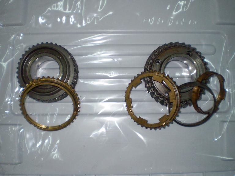

Double Syncroniser upgrade for Mitsubishi Gearboxes code F5M21/22/31/33, W5M31/33. Used in Proton and Mitsubishi Lancer, VR4 and Evo 1-3 Gearboxes.
No More grinding gears, you can shift at 9,000 rpm with no problems.

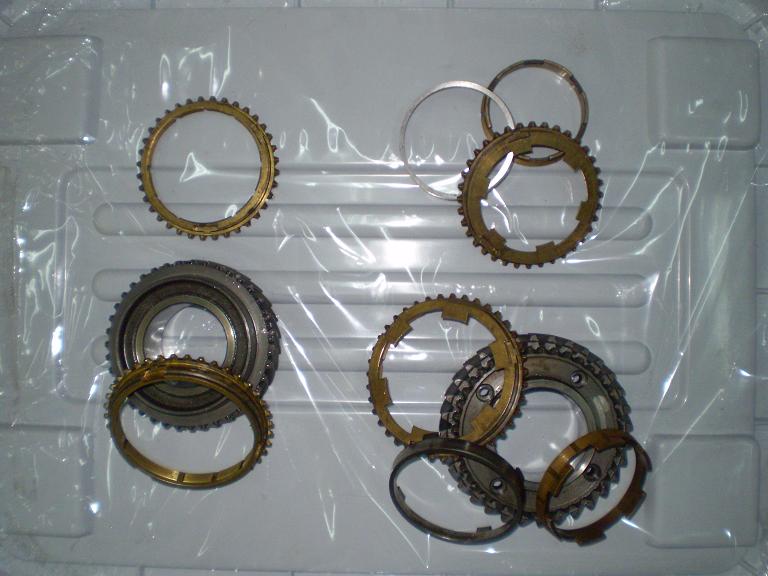

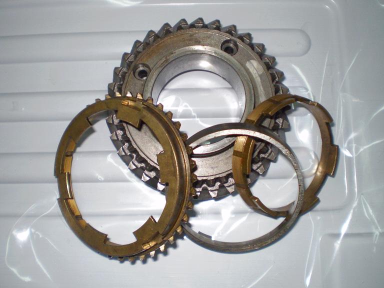

Pics attached below. Left single Syncro, right double syncro.
