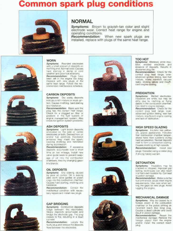

AFAIK, as long as you use spark plugs wif the correct heat rating that the engine manufacturer's recommended... no problem whatsoever... using different materials such as platinum/iridium only serve to pro-long the plugs life that's all...
if you go too 'hot', you'll experience pre-ignition leading to detonation/knocking and damage may occur. If it is too 'cold', electrically conductive deposits may form on the insulator causing a loss of spark energy or the actual shorting-out of the spark current.
at least that my 2 sen la
btw, which one describe your spark plug's color?

Forgot to add, found this at http://www.automedia.com/Spark_Plug_Diagnosis/ccr20030701sp/1
Normal, but with red coating: The red coating is a result of the additives in lower-quality unleaded fuel and will be visible on the plug's ceramic insulation. The red coating is not an indication of any engine problems.
Thx bro papagoines for your kind info and the chart. Well at first it was more to overheating but just now when check the plugs again, it seems to be back to normal again ....... I guess i'm running too lean of a a/f mixture.

Thx bro papagoines again for your useful source. Really appreciate it !!!
After reading it, its seems like the might be problem to the fuel too ......
Something is fishy with this petrol kiosk i went to the other day .... I was running average 350 km / 27.777 lit . All in a sudden only manage to run 290 ......
