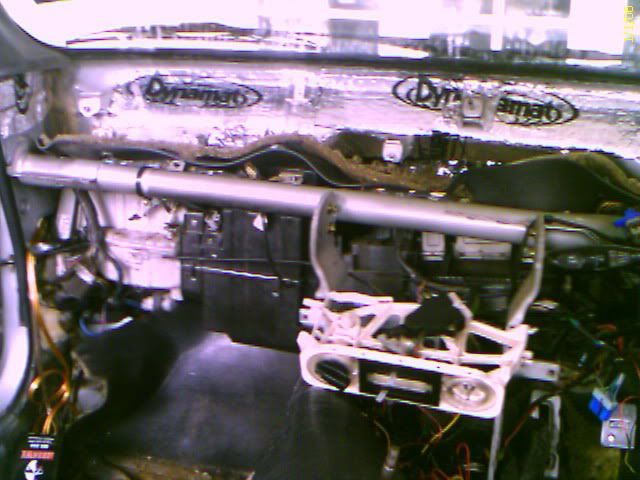

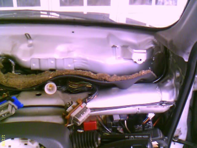

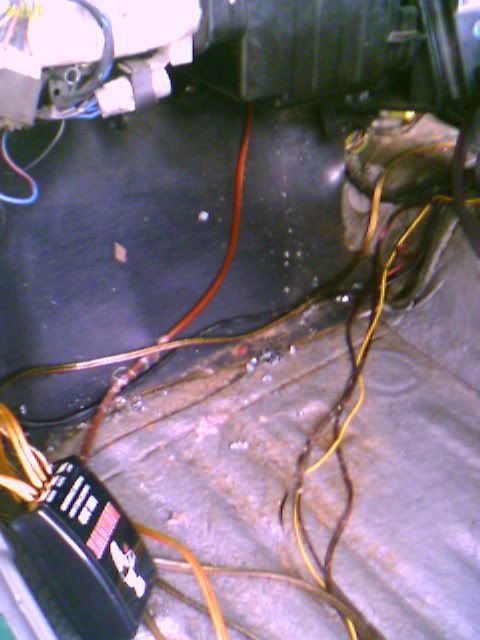

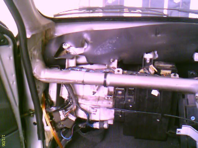

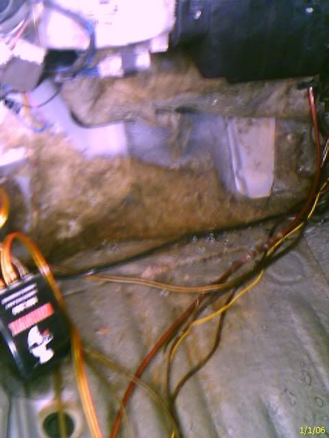

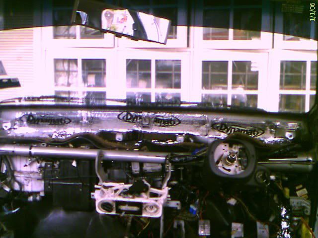

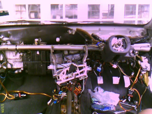

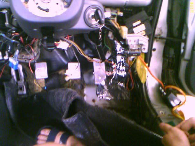

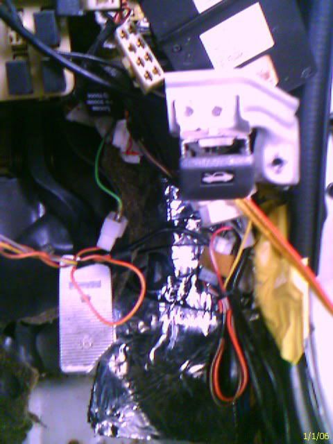

Here you goes... some idea for you .... we took 2 days to settle it...
wow. that's quite a lot of noise reduced.... but have to DIY ler... if pay someone to do, RM400 for workmanship also not enough.

If you want to block the sound in to the CAbin then you need to stick the whole fire wall la... but the cooling coil is attatched to the fire wall mah.... unless you want to refill the guess again...else please do not touch it la... so that part you cannot stick la... also it cover quite huge part ma.... so not that perfect la..
zane i`m sorry if i`m stupid but what is that cooling coil that your are refering to what model car ? i`m damn blurr la from the outside i didn`t even see a cooling coil i onli see a compressor ....
I mean the passenger seat.... there is a drawer infront... after you took off the drawer... you will see air cond... cooling coil...with the blower...
