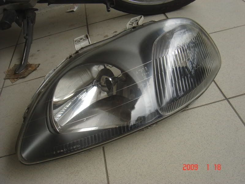

http://img254.imageshack.us/img254/2601/dsc00121fe0.jpg
After spray..remove all those tape and pump abit of transparent silicon (RM8.90 bought at hardware shop)at the "longkang" then attach back the rear n front pcs of the headlight..and this is the result of it....
Spray = RM 5
Silicon Sealant = RM8.90
100 Plus = RM 3.90
Marlboro Light = RM 9 but smoke few stick only
Result of the headlight = PRICELESS SATISFACTION :D

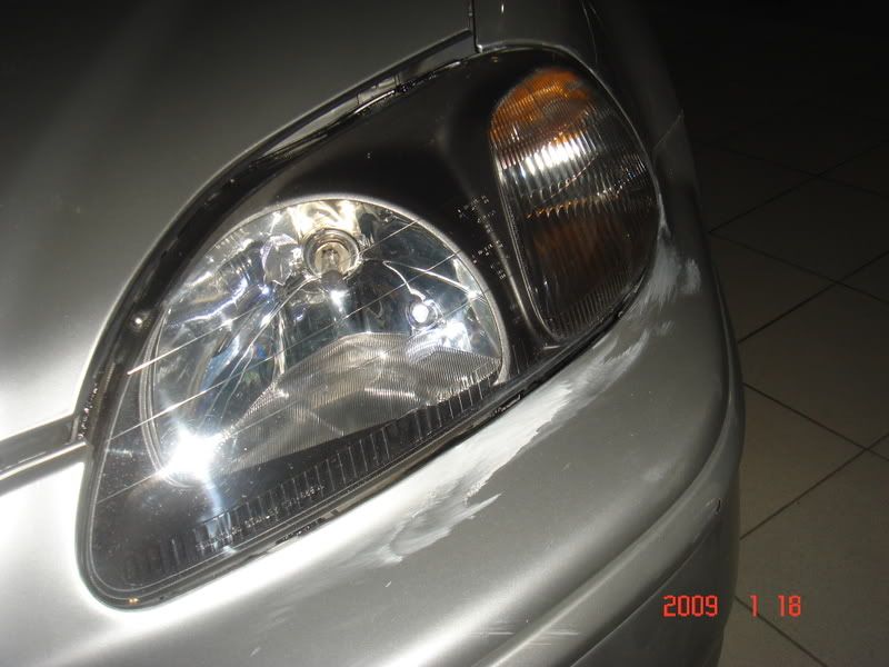

This is how mine turned out, started with matte black then sprayed on with Gerhana Grey, result's almost like gunmetal in my opinion =)
