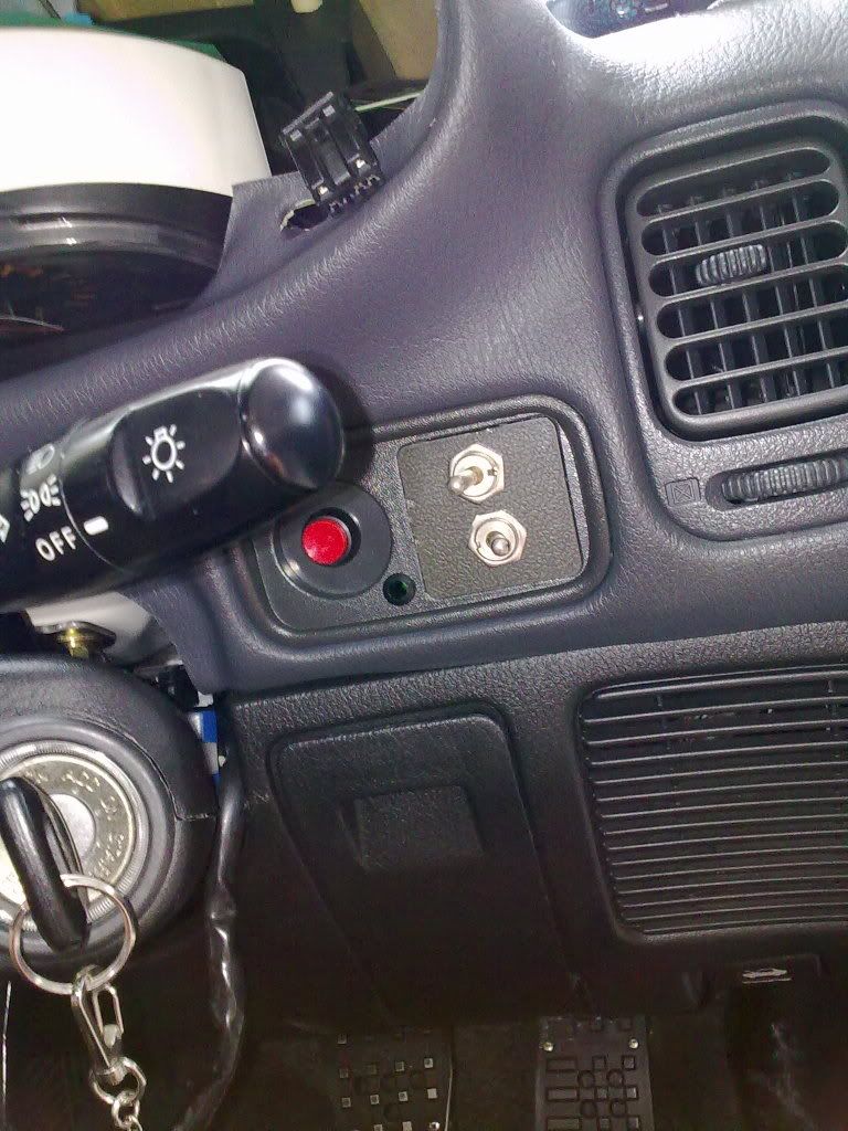

hi guys, as promised the pic of my switches
kool! aih..wana do dis project also...wait got extra time n money lorh..
now no space to work..hehehe
haha.. learn from my mistake, if u are gonna do d starter button take note:
1. make sure its a high amp wire (i used wires for houses)
2. use a relay (mine doesnt have dats why they are not working anymore

In a simple way, think the switch as the way in between live(+) and to the load (+)(device)
(-)load to (-)ground/car body
