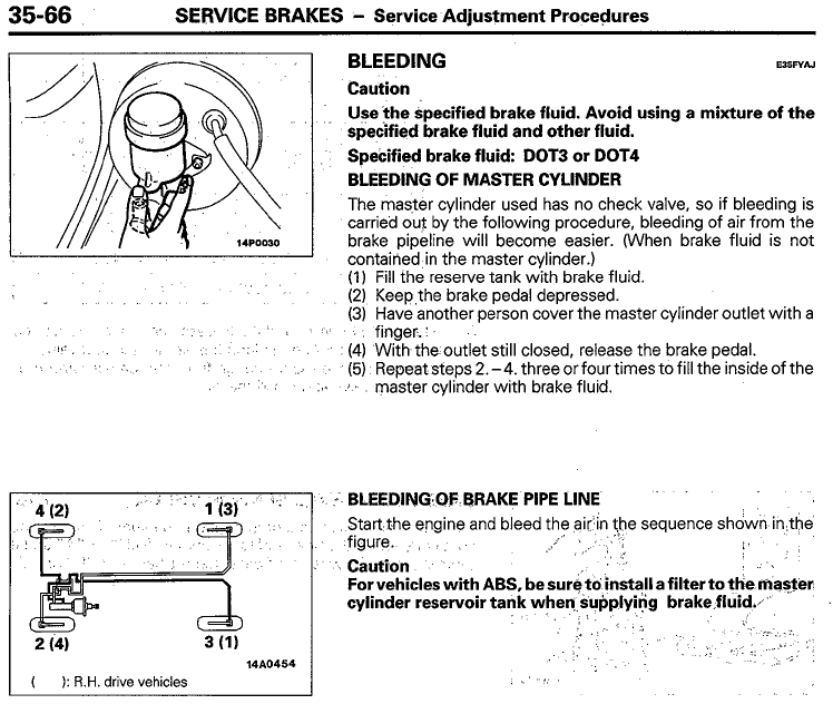

The reason u have to bleed twice i think is because u didnt bleed the master brake pump when u install it.

How to bleed the master brake pump?
I was not aware that needs to be done. But the 2nd bleeding was done on the front wheels only cause during the first bleeding, the rear wheels was the last to be done. So can consider as I started bleeding from the rear on the 2nd bleeding.

Bleed like the picture below or u can search it from youtube for another method.
jus extra info.
for the bleeding sequence, i think it is related to the proportional valve.
*The attached service manual is from mitsubishi mirage.
Yup, if you have taken out to clean means system is empty then have to bleed the master pump first.
If just changing brake fluid then take old oil out from the reservoir add new oil and bleed from the 4 ends. At each bleeding end pump until new oil comes out, while keeping an eye on reservoir not to go empty. If can find a tube to fit to the bleeding nozzle and lead to a container, it can be cleaner....:biggrin:

Yeap, guess my other mistake was that I did not bleed to master pump which is possibly the cause for the spongy brakes after the first bleeding.
Instead of a tube (cause i could not find one readily available in my house), I used a newspaper and a bucket.
