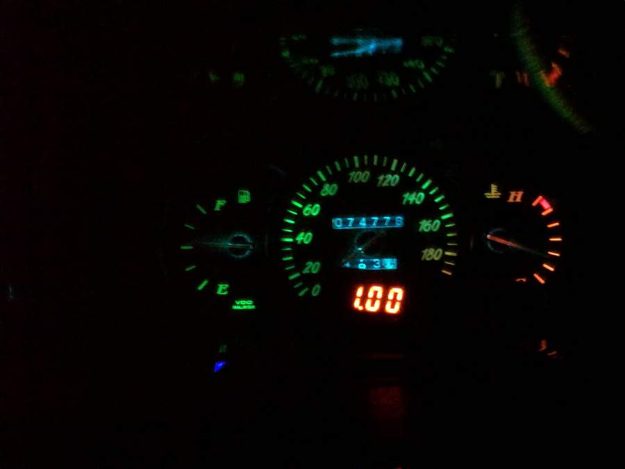

nice or not??...
Nicely done Skywalker.. Mind asking what LEDs are you using. Haven't really taken out my dashboard's meter to see what bulb is the meter using. Is it t5, t10 . Does it necessary needs the rare t4.2?
so freaking bright man!!!

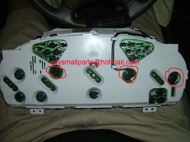

dismantle out the meter 1st
check using t5 or t10 bulb~
rear view meter picture got circle is the bulb need to change..
bulb size
t5 and t10
also, test before putting it back. LED have +ve and -ve (positive n negative) so if any section of your meter cluster is dark, just flip over the LED and test again.
