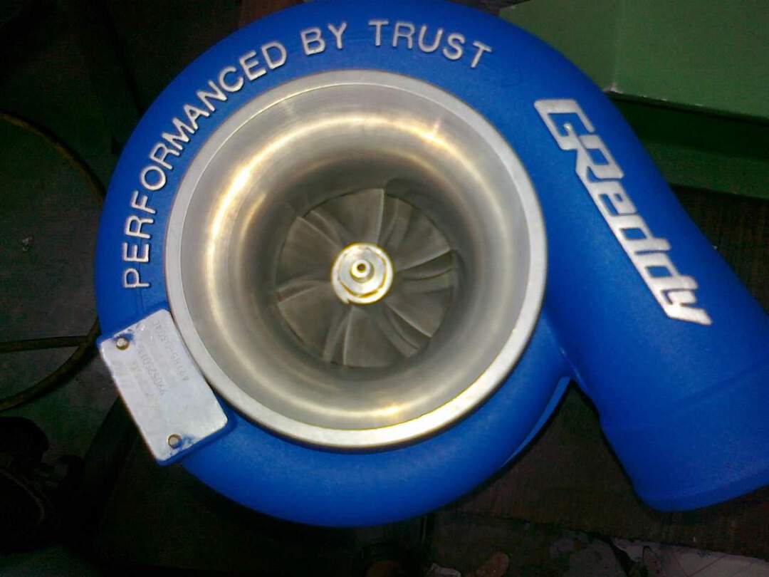

depend on u la bro..what u want...if 2.2L or even 2.4L still can use stock td05-16g...so if upgrade to 20g shouldnt be a problem..even gsr93 used 20g setup..:hmmmm:
then turbine wheel..same story with compressor wheel..can change to bigger turbine wheel...either td06sl2 or td06h.. it sound simple and easy but it not..:idea:
p/s: i want to let go Greedy t67-25g-8cm2...selling fast but it not cheap..hehe:burnout:

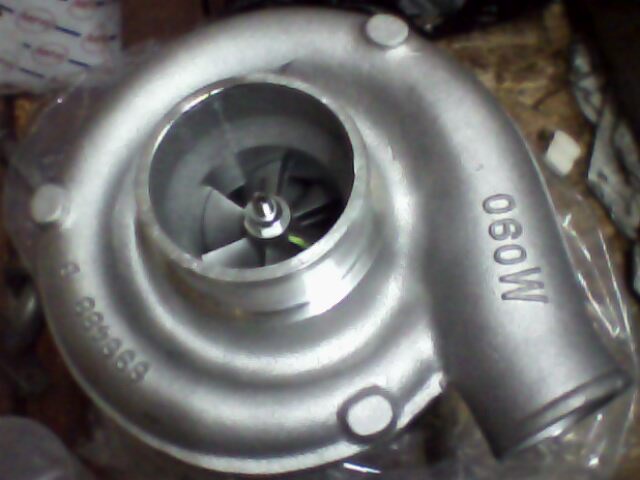

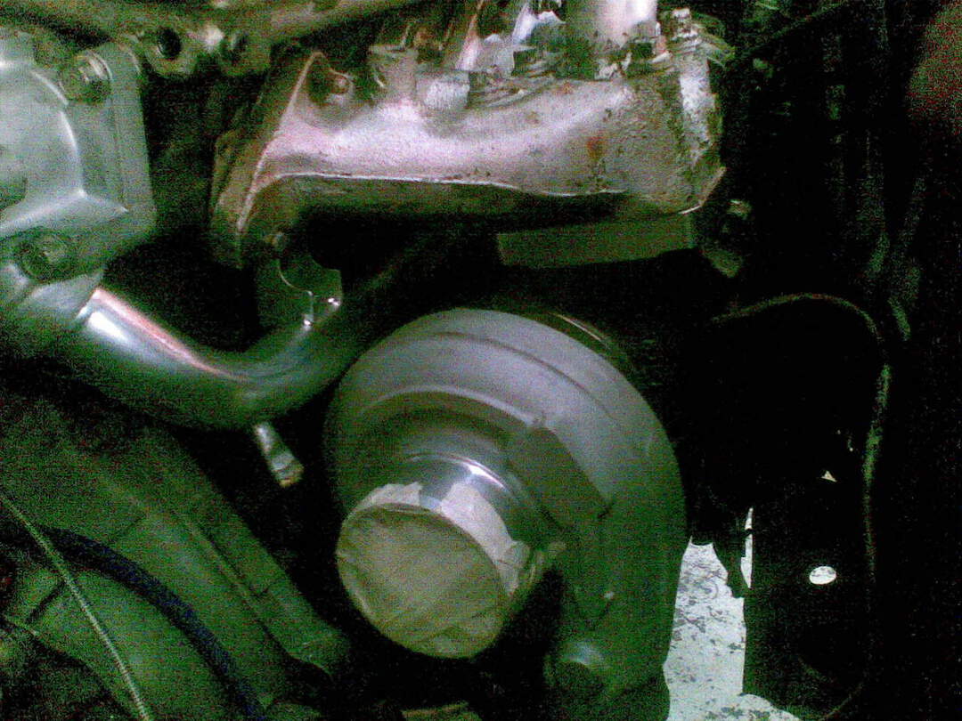

u might be able to run 60-1 even with the stock engine if u buy the 60-1 with bep housing..spool kick in around 3.8k rpm in stock vr4..!
u can go with stage 3 but i do prefer stage 4 p trim...
or..go for s256 dsm non ett..4g63 stock ? no problemmo...Pnp to stock manifold
