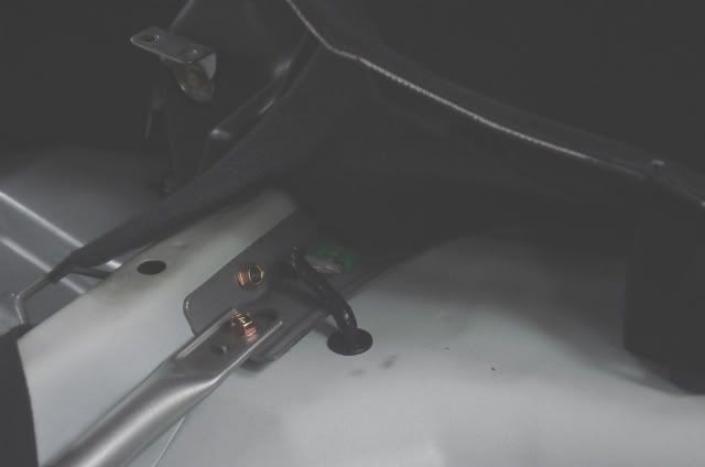

subcon, do you know exactly which screws did the mech tighten to get rid of that low-speed noise at the rear?
the culprit!
http://i253.photobucket.com/albums/hh75/subcon07/DSC08095.jpg
hope this helps!
the culprit!
hope this helps!
that screw,... hahhahaaa!!!
anyway, guyz, if ur dc5 comes with rear seatbelt, and the centre lock latches are kept under the seat,... THAT also might create sound, audible during slow driving,...
uhhh subcon, im not sure i get what youre trying to show in the pictures.... you mean the rear strut bar screws were loose?
my sound is like a VERY MILD krink krink krink krink when the tire turns at low speeds, but as soon as i press the brake, the sound is gone! i was thinking it might be somewhere near the brake pad, maybe something loose down there...
is your sound the same?

my two guesses:-
1. a small pebble found itz way inside, in between ur rotor and metal rotor cover
2. if ur tyre valve is tightened with two small nuts inside the other side of the rim,... one of the nut might hv loosened and dropped,... thus this is the sound of that nut rolling inside ur tyre.
item 2, i experienced,...
hmmmm....thanks fobs, will get it checked this weekend so i'll pay attention to the items you mentioned.
thing is im also confused if its a pebble or tire valve nut, the moment you tap on the brake, it completely disappears....almost as if its hanging on the brake pad or calipers.....
