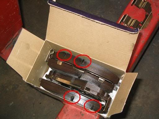

2. stop your car, check the "longkang" at the brake pad. if you still using the stock brake pad, there are "longkong" (2 at least) on the pad, it's 1 of the indicator for brake wear.

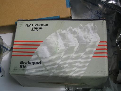

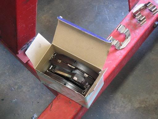

Check this out, brand new Genuine Hyundai Coupe Tiburon (RD1) brake pads , and compare the "longkang" with yours, errr, i mean your brake pad. :biggrin:
far view
The box
of course if your brake start giving you noise, time to change as well.
