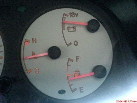

what is the 20v temperature under normal drive and hard drvie condition..?
mine the temperature indicator hands to 8 o'clock in normal driving and
it hands to 9 o'clock when hard drive (rpm maintained at 6-8k for 20 to 30 mins)
oh..my water temp meter is different from you...i see one before , from left to right, mine is bottom to top...

ok...this is the water temp condition..
normal drive in morning with light traffic
is it normal ?
However, it will raised to half when hard drive !!!
one SC owner told me his temp usually hands to 7o'clock, just raise from bottom end when raining day...!!!
