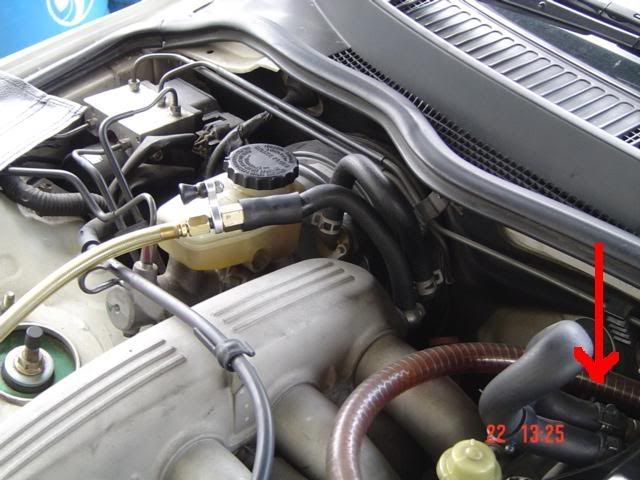

do the same as shown. make sure after u bypass, u clean the holes with water.. pressure it until all those rust come out. BEWARE !!! HOT
