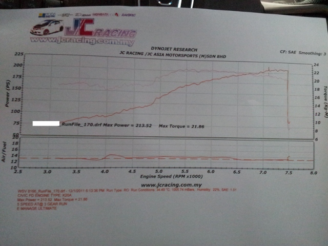

Dear bro below are the spec for my ride .
Engine part
-fd2r head
-K24a block
-wiseco 12.5 compression piston with 87.5mm
-ACl race bearing with engine block sleeve
-stock intake with K&N drop in filters new
-FD2R intake manifold
-hayden gearbox oil cooler
Suspension and tyres
-brembo disc and pads
-Bridgestone RE505A II rtp run flat tyres with 70%
-Bc Br series suspension 32 clicks
-Brembo Disc and Brembo Pads
Handling
-Full ultra racing bars.
Exhaust
-Super circuit 4-2-1
-full customize piping straight till mufflers.
Management System
-Emanage Ultimate
-Vmanage cam controller
-NRG oil temperature and oil pressure gauge.

i have some picture with me to proof ... and if not you can open the engine to have a look i dont mind bro ... even all my previous bearings and piston is still with me ...can give it to u if u needed it as well .. ^^ .. you can dyno the car as well ... 2lobe stock ivtec head wont be getting that much power also ...

hi bro.. the max power is in 7.5k rpm? cannot rev higher?
one more thing, could you share with us/me how much it would cost you for k24 block and fd2r head?
nway, nice single-foot car dude...
yea can go higher but i have to limit it due to gearbox ... if rev too high scare it cant takes it or sometimes when enjoy pedal will over rev hahaha ... any how the power now is driveable and i would say rev with peace of mind hahaha ... the cost to mod the engine part i think cost me bout 30k.
