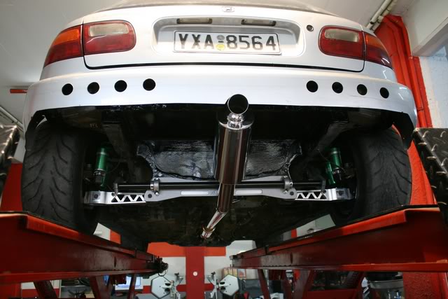

heres some examples of subframe tear
Crack
WALAUWEEEEHHH!!!
my advice, get the ASR brace.. and get rid of the tie bar. coz the brace will also act as a tie bar...putting both will actually make the tie bar useless as its bolted onto the brace. (u can sell the tie bar and use the money for the brace. 2-in-1 function and looks sexier too)
the spoon tie bar does NOTHING to reinforce the subframe against tearing.
but according to THIS thread, its more prone to EKs than EGs..
Subfram tearout is exactly that- where the subframe (where your rear LCAs and sway bar mount to) is put under heavy stress from a large sway bar and tears. Its a common problem on EK civics because Honda placed the sway bar mounting holes outboard of the LCA mounts, and used very thin sheetmetal in that area. Its also a pretty damn expensive fix. It looks something like this...
Madman where to get original ASR Brace , i see some selling for 300+ and some 700-800+..
How to tell the difference..
the 3xx is the price for the replicas... 7-8xx is the price for ori...
read this to know how to tell the difference: http://www.jhpusa.com/blog/?p=72
as for me....im using the replica since the day i got the car in december
