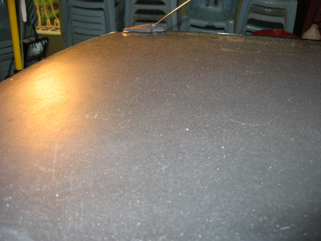

as his car cant be sold as the paint work on the roof is 'dead' aka heavily severely oxidizes, the buyer refute the buy till this is resprayed. He actually contacted the body shop, last week when i was drop by his place, i suggest
'why not let me to resurrect it'
this was the 5th ride, after we detail 4 full size passenger van.......in 4 hours

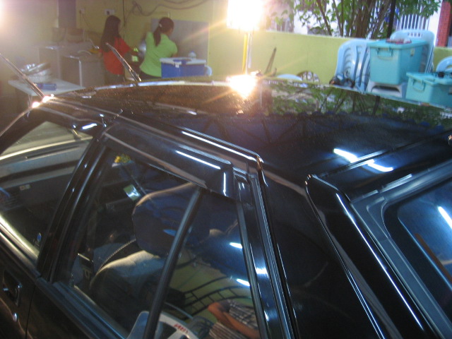

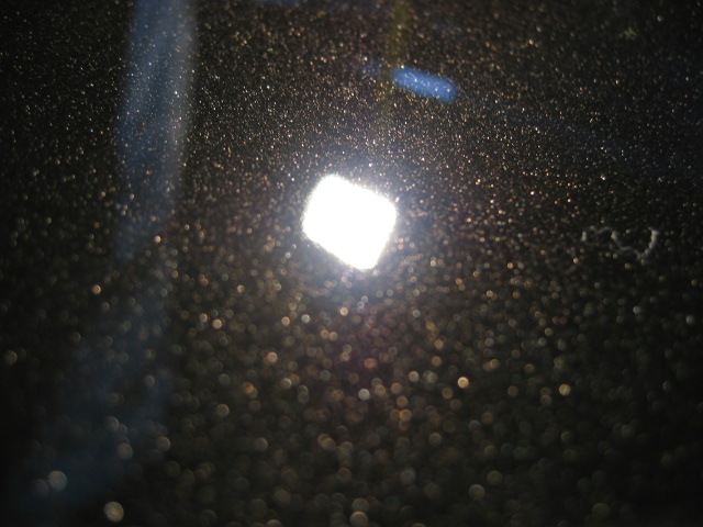

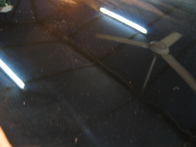

''Dead paint'' aka ''heavily severely oxidizes''
thanks God all of my fellow fanatics detail was there side by side to goes thru this togather
Dead paint aka heavily severely oxidizes

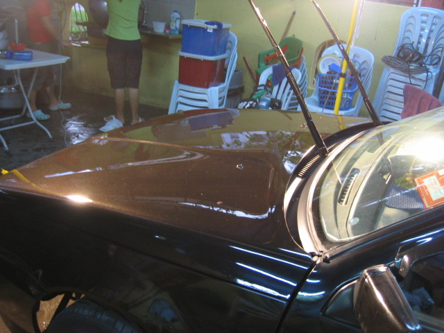

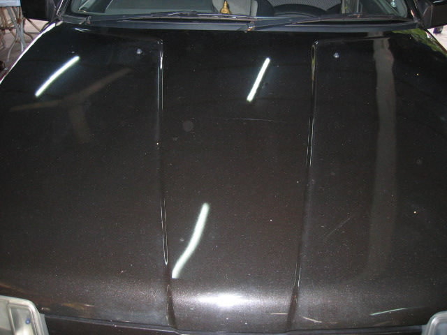

the front hood was not so bad but some spider attacked & left some signature there
front bonnet

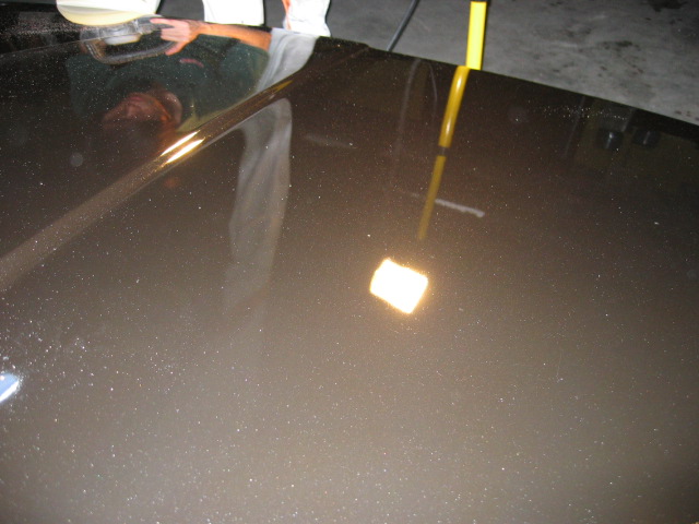

claying begin Detailing fanatics Seech did the whole bonnet
Megs M105 with solo burgundy wool r/speed 1-3-2-1
wash down with ONR & dry by 2 microfibers
Megs M205 with Megs soft bun with r
NXT ed with 2.0 by hand

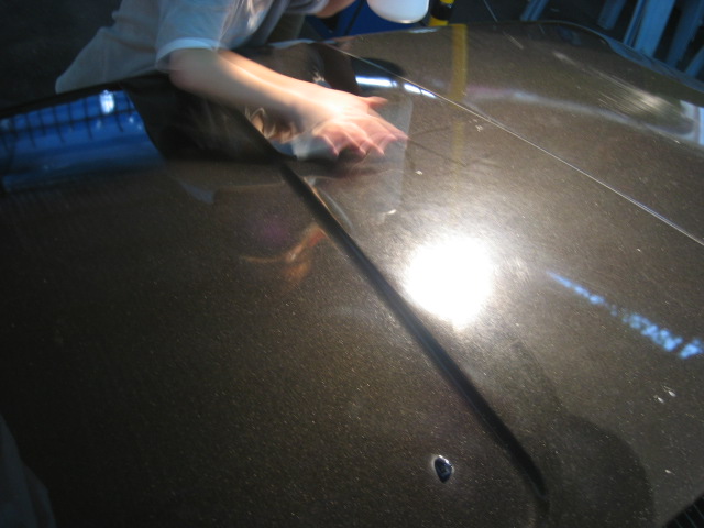

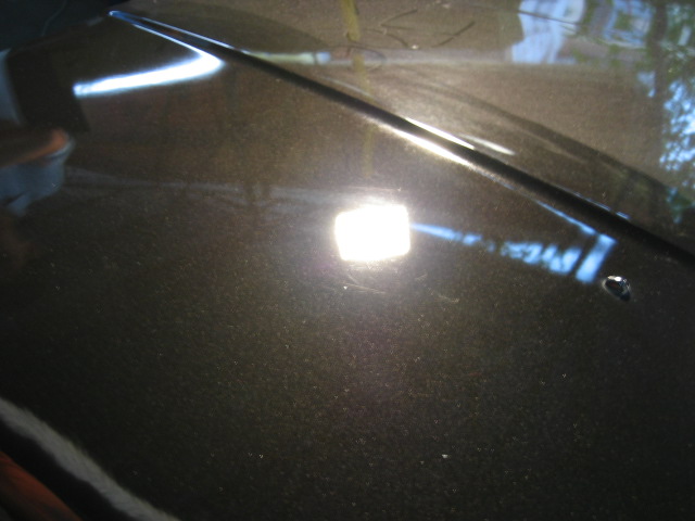

ta ta ta after pics
remember before
in the process pics
after 2 passes but rids still visible

Seech at work

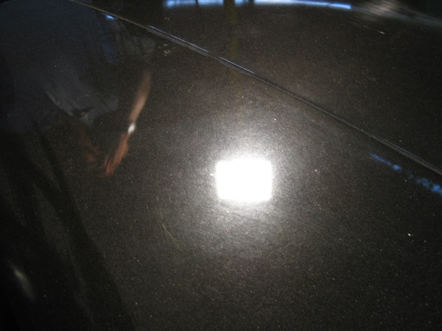

after pics
thanks for 4 pairs of hand ..got in done in 3 hours ..total 12 man hours
ma ma mia
glittering again

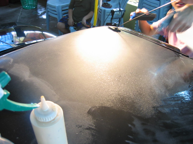

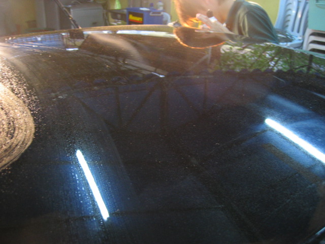

roof - Hitachi, Fishbonez & me

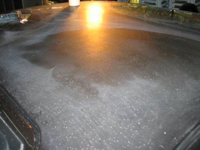

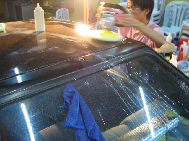

compounding with single sided wool/r speed 3 - very minimal effect
wet sanded with ungrit Megs sand paper 1500
continue with 2000 grit sand paper

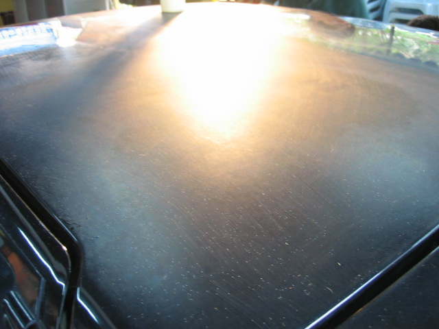

Rotary/speed 3- Osren Nano Cut 1.1 - with Lake country single sided wool
continue 2nd sanding, as the oxidation is so severe & our experience detailer suggest go further, as it doesnt have paint transfers on all our wool & pads, mean to say this is repainted
wash down by ONR

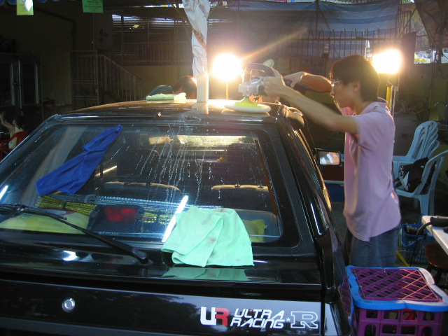

Meguiars 205 with soft bun to polish /rotary speed 1 -2 -1 - by Fishbonez
NXT 2.0 hand wax

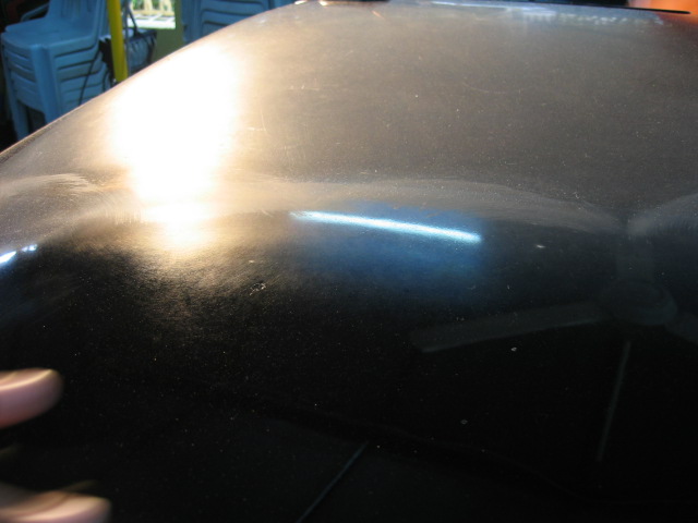

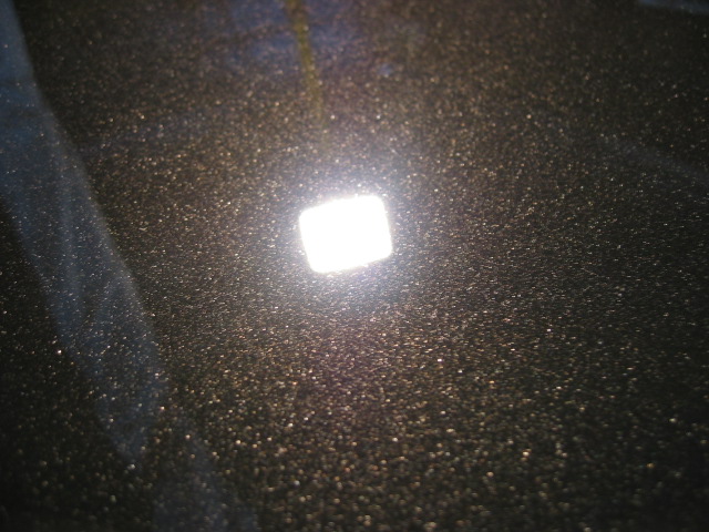

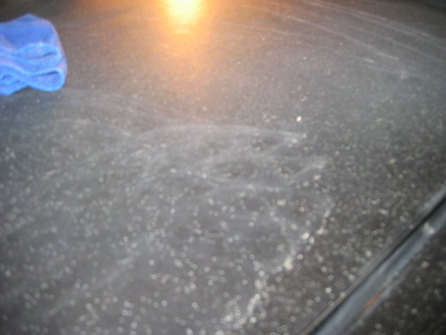

initial attempt

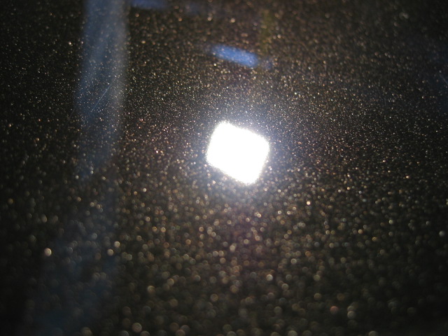

tried to compound off
but shown no different
AKA dead paint.....
At a glance Sifu hitachi, by t his experience he advises to sand off,
as this is heavily oxidizes

self taught legendary detailer aka fishhbonez begin sand off with unigrit 1500 sand paper
ressusitation begins
master art at work
a couple more compunding passes but still alot of pittings - not much of changes
continue sanding for 2nd time

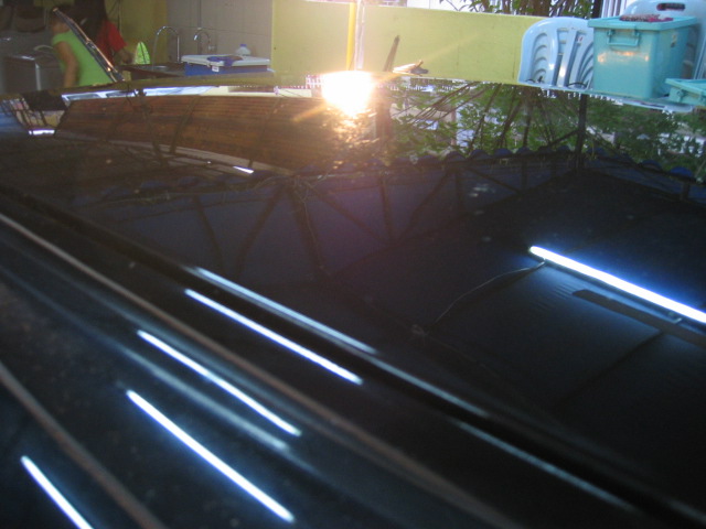

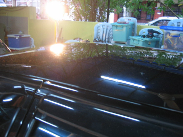

some 50/50
after
remember before...oxidize & pittings
now ..
mamamia again
and again
