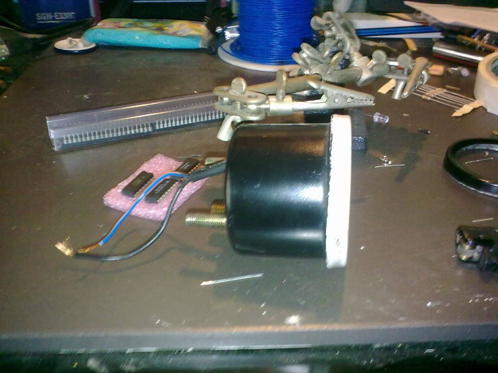

step 1: remove all connections from your gauge and you should end up wit something like this

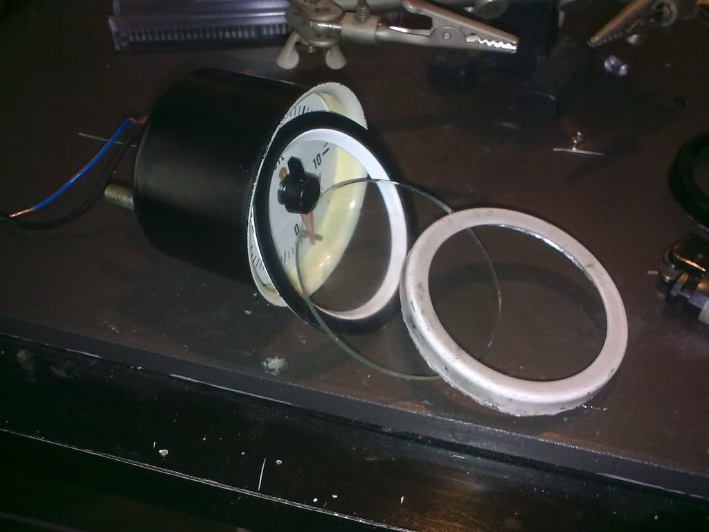

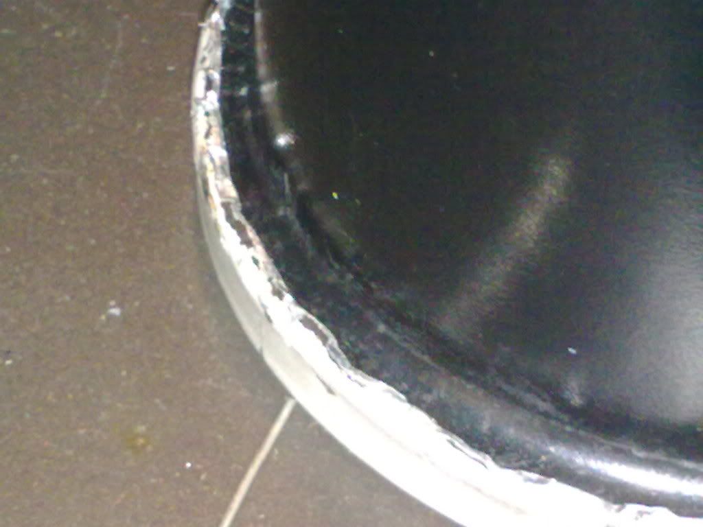

-you'll notice tht there's no screw at the back to remove the bulb or disassemble the gauge from the back. so what you've to do is use a flat-head screwdriver and slowly push into the part where the front cover sort of overlaps the gauge's body. go through the whole edge and you should end up with something like this
-repeat it until you can completely remove the cover and here's how it should look disassembled:
(brim - glass - glass seal & inner brim(nt sure wat it called- its the one wit the white rim and black edge) - body of the gauge)

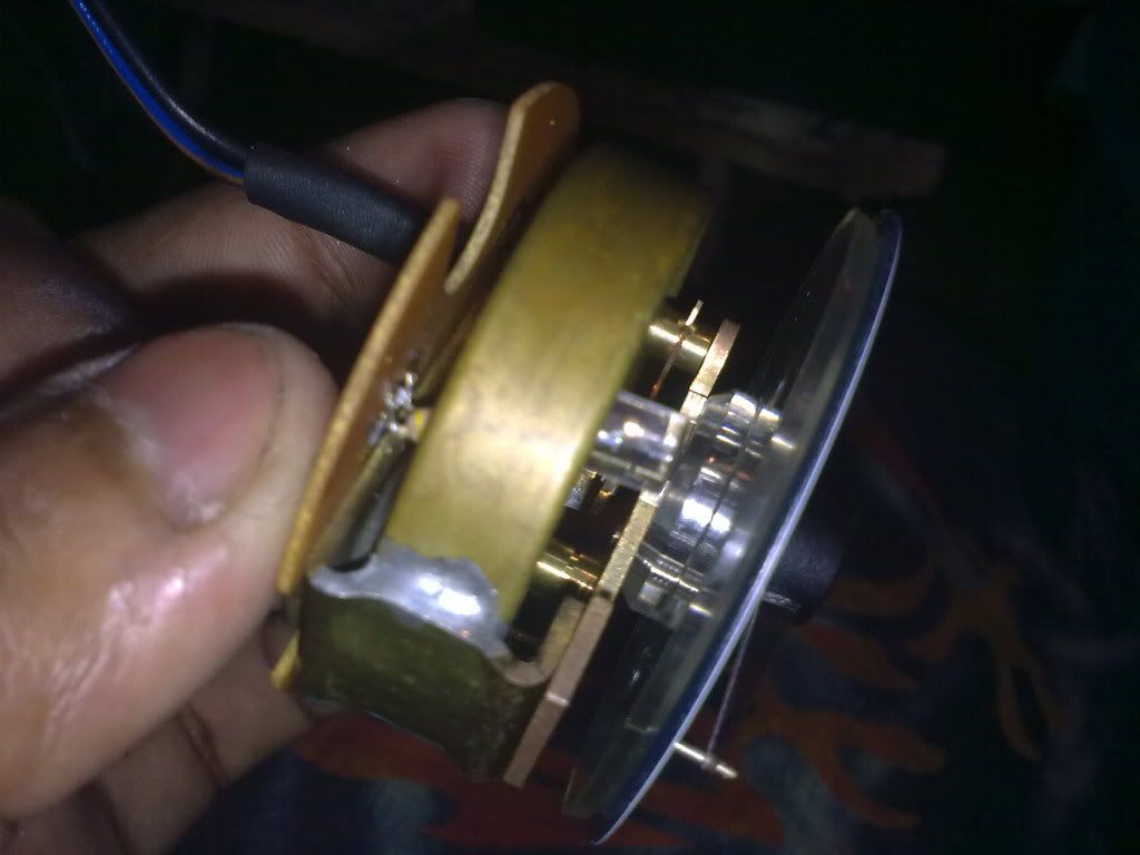

-once all the above is done, the whole mechanism will pop out. WARNING: be very careful with the mechanism or else the calibration will run out; the same happened to me and i had a though time recalibrating it... this is how it should look like once the mechanism is out.
http://s906.photobucket.com/albums/ac270/daku2427/omori%20gauge%20bulb%20replacement/100420101281.jpg
http://s906.photobucket.com/albums/ac270/daku2427/omori%20gauge%20bulb%20replacement/100420101277.jpg
those are the bulbs you need to replace, finding a replacement for these is pretty hard
