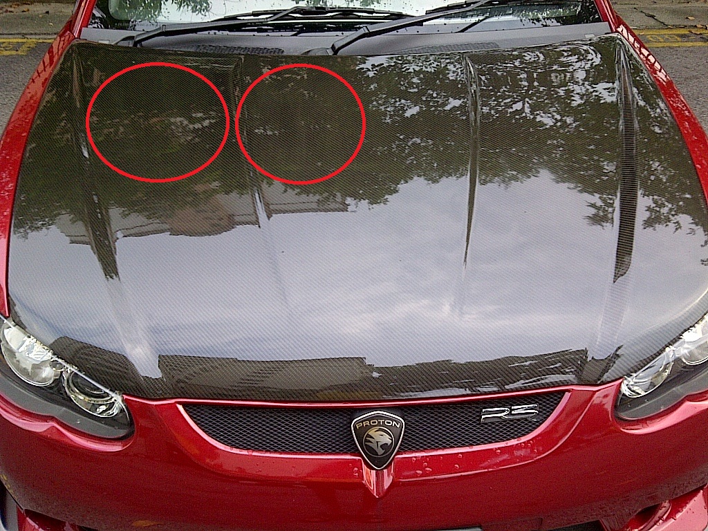

My CF hood is getting yellowish and the color becomes uneven (look at the pic). I wax my CF hood every 2 weeks using optimum car wax. Is it because of over wax? Some people said the uneven yellowish color is due to dirts which trapped inside the wax layer. If I use clay bar to remove the wax layer can I restore the color back to the original? Or do i need to polish? Or maybe reapply clear coat? Please help. Thx

I would try stripping off any wax with some Power Clean and see if the marks are still there. When applying OCW, don't use too much. For your hood, 2 squirts are more than enough.
Yup. If it's patchy then it *could* be dirt/contaminant trapped on the surface or already stained the wax layer. Try to strip everything off with an APC (all purpose cleaner) wash, or maybe you can try claying also, and see how it looks afterwards. If you don't have any APC on hand, you can try a mild dishwashing detergent mix or get one of those al-cheapo shampoo from the locar mart and mix a very strong solution of it (but just remember to rinse VERY THOROUGHLY and NEVER let any of the solution dry on the paint).
If it's still patchy, then try a paint cleaner or a mild polish. If that also doesn't work, then it's a job for the pro.....
its the clear coat that turn yellowish overtime
if polish don work u might hav to sand the yellowish part and reapply clear coat
it happens to most carbon stuff
ok.. i will try to remove the wax layer using clay bar 1st and see how it goes..
not really sure if it's the problem with clear coat that turns yellowish.. coz im using this hood just about 5 months and i wax every 2 weeks to protect the clear coat

I have read at some forum that the yellowing of CF may be suspected of heat and deterioration from underneath, not from the top surface of the bonnet. The heat builts up from the bottom, and the yellowing effect shown at the top.
Is the yellow patch coincidentally located at hi-heat area at the engine compartment?
Mine become greenish.. what should i do?? :tee:
use clorox
Bro stuffx, is the underside of the CF hood clear coat also experiencing yellowing?
i cannot tell if the underside is also yellowing by just looking at it. maybe i need to clay the whole hood 1st to see whether it's just on top of the hood or underneath the clear coat

it's an aftermarket hood. i'm not really sure what do you mean by original because it's hard to see any cars come with original CF hood.
i put heat insulator under the hood to prevent heat from engine bay..
no it's not yellowish at hi-heat area.. i can see the whole hood is yellowish under direct sunlight (look at the attached pic)

a noob question here... the above happening to bro stuffx CF hood is it not normal? For me... I think a yellowish CF shows better contrast... As long it doesn`t fade off the whole clear coat and become DCF... Then it just looked like some unpaint taiwan/counterfeit body parts....
a brand new CF hood will look blackish even under direct sunlight but u can see the CF texture.. mine looks blackish only at night or when not being exposed to sunlight.. fyi previously i kinda like the contrast too but now i started to hate it LOL
