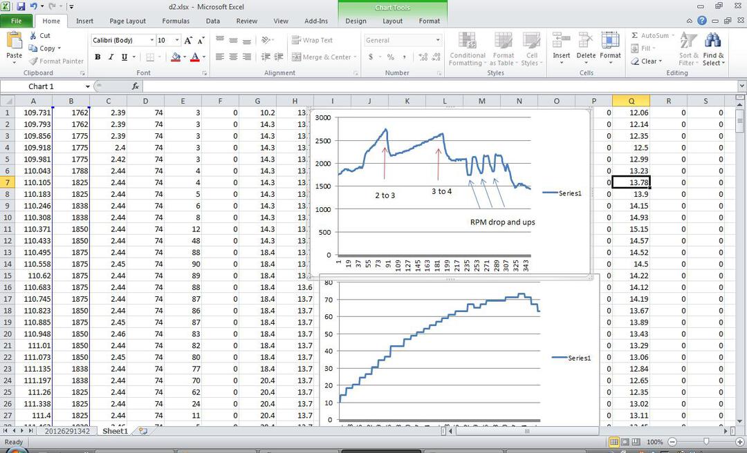

Just got my Cefiro A32 2.0 2 months ago. Changed the flywheel oil seal due to oil leak. However after that whenever I am constant on the gas pedal @4th gear (5% 50% throttle), the RPM move down and up, repeating unless i let go the gas or press more to force it go down to 3rd gear.

Attached the consult RPM(series 1) vs Speed(series 2) graph. Sorry that I couldn't get the Scan tech nissan working (so i can read the TCM's data)

Does it feel more like a gearbox or engine engine problem. Since you don't have the problem in the other gears it would presume a gearbox problem. If it is a gearbox problem and its only on 4th it looks like a lock up clutch problem. Looks like the clutch is locking (rpm drop) and unlocking (rpm up). Its could be the lock up clutch itself or it could be the lockup clutch solenoid. Or it could be a sensor or signal problem which is causing the lockup clutch to open and close. It could be the lock up clutch is worn also. So have to slowly check. easiest way to check is to get another gearbox and do a direct replacement just to check if the problem still there. If the 2nd GB also has the same problem that means the GB is got getting some signal from the ecu. Or its an engine problem.
