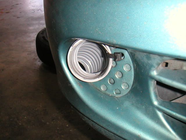

i've done one for gasing a zth forummer :)
this is a GOOD area for CAI
high-pressure area, and plenty of air for the hose to suck from. :)
used a drill to cut a circular hole, used a Dremel rotary grinder to smoothen out the rough parts :)
had to use a cable tie to properly secure the hose.. hehee
