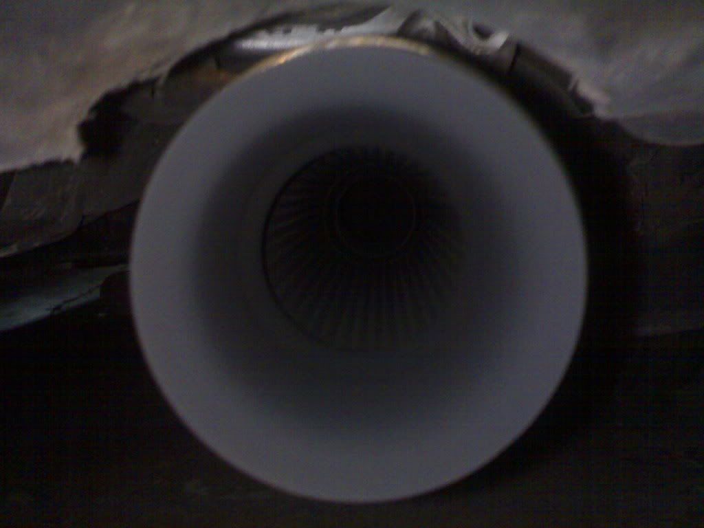

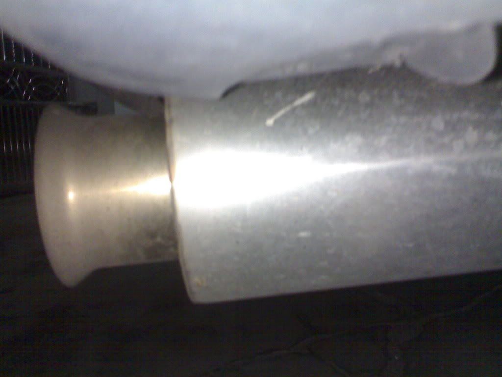

oh yeah can i use my old vtec muffler as my bullet???
tis is the muffler looks like
izzit bullet better or how ??

AFAIK, muffler cant be used as bullet as inlet and outlet is not same size.
din we can welding it also ? many of my workshop use two spoon muffler ...one as bullet and one as muffler.../

just my question ah...can my muffler jadi bullet??? anyone know?
