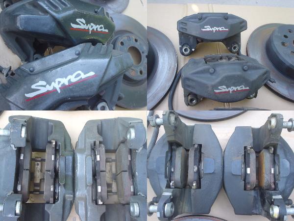

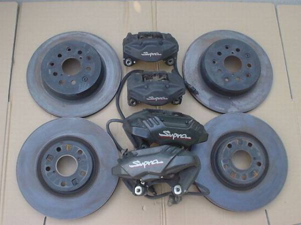

Dear all experience altezza owners,
just want to ask newbie question regarding the below brakes from Supra
(click image to enlarge)
https://www.zerotohundred.com/forums/attachments/292937.vB
https://www.zerotohundred.com/forums/attachments/292938.vB
1. is it 4-pot front ?
2. IF IT IS-4 pot front, can it clear stock 17" rim of altezza ?
3. need to mod mounting bracket ? or straight plug & play ?
thanks in advance.

1. yes 4 pot..
2. dun think can clear stock 17" rims
3. yes, need to mod..

Our altezza/aristo/chaser/supra all share the same front n rear wheel housing, so the supra front n back calipers should fit nicely. probably a little mod is needed thats all.
Front.
Supra 4 pot can fit into the stock/oem 17" rims. but stock rims offset is +50, so u will need at least a 15mm spacer to clear the supra caliper.
Supra disc rotor is 323mm size, this will clear all 17" rims.
Probably need to mod the bracket a bit. Mine is minimally modded at vision bangsar. bought the front set brand new for rm3000 few years back.
rm3000
new 4 pot calipers
new disc rotors 323 mm vision
free toms brake pads. brake lines i reuse my own
i think now more expensive lo.
Rear.
rear supra will clear our stock rims with no problems at all. Disc size n 2 pot calipers will not be a problem. no need spacer. bracket need to mod? this i dunno
only problem is finding the new disc rotors for the supra rear calipers. These are different from our stock altezza rear rotors. They are ventilated. can find? hahahahah.
cheers n good luck
