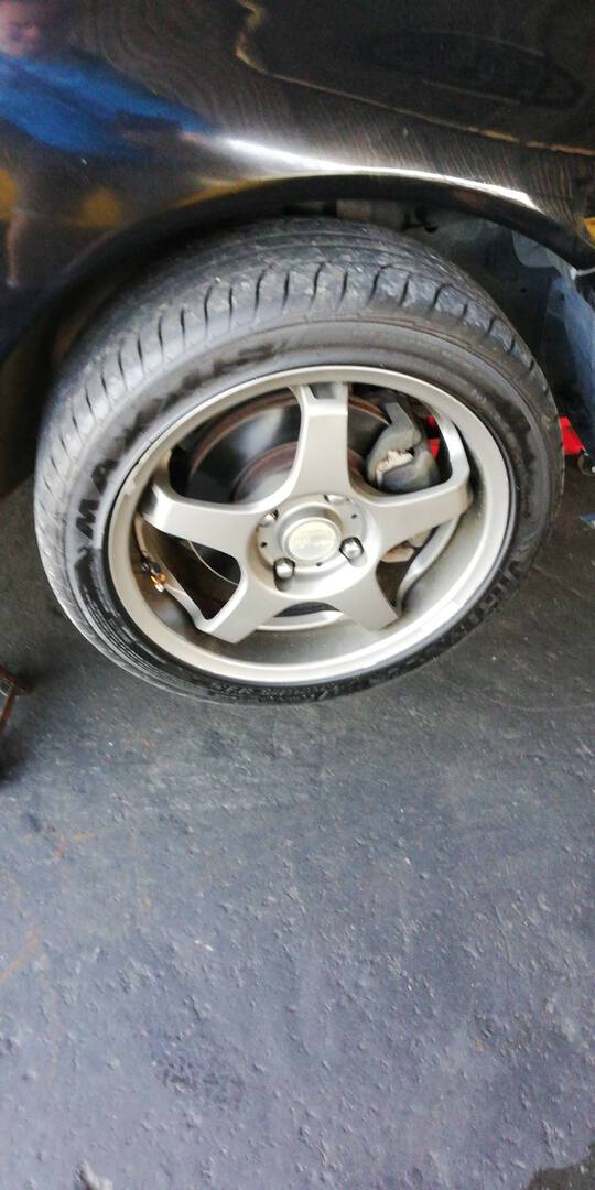

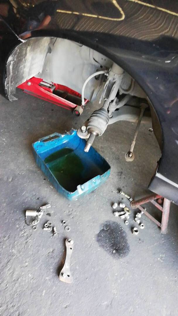

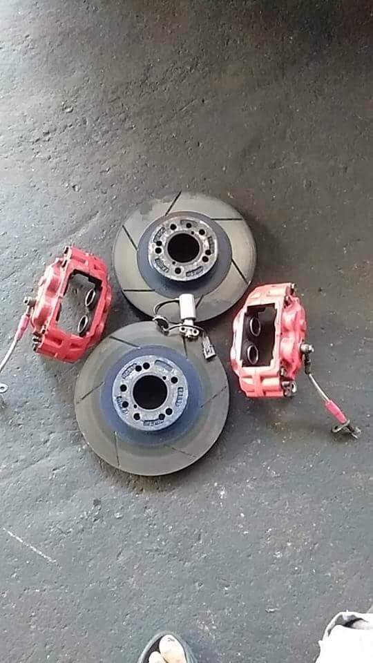

hi, so first I would like to apologize to all my friends from this forum, have been very busy and not had much time for my Lancer for a while, but finally got some time and have done a brake upgrade, using some Subaru 4 pot calipers and disks

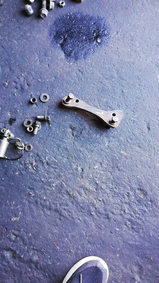

just adapters to bolt on from the caliper mounting points to the mounting point of the stock caliper on the hub
but the adapters were simple no welding or shaping of the metal so the metal keeps its strength
also the disks were re-drilled to suit the 4x114.3 stud pattern

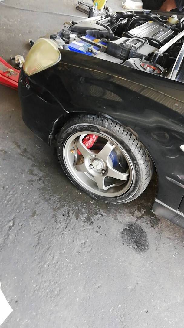

Fitted fine under my 16" Enkei wheels
owner of the shop told me Subaru 4 pot is a much easier fit to Lancer than other budget 4 pot options such as Skyline R32 and Toyota Vigo pickup.
