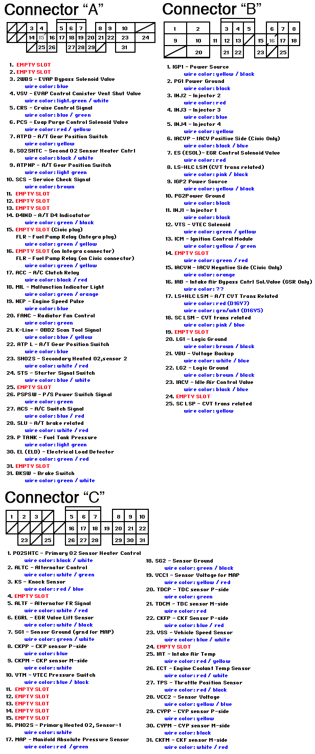

You are "missing" which connector? ... this is the ecu diagram pin out

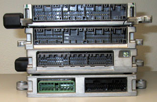

Reconfirm.... your ecu from top 1 or 2?
1. OBD2B
2. OBD2A
3. OBD1
4. OBD
