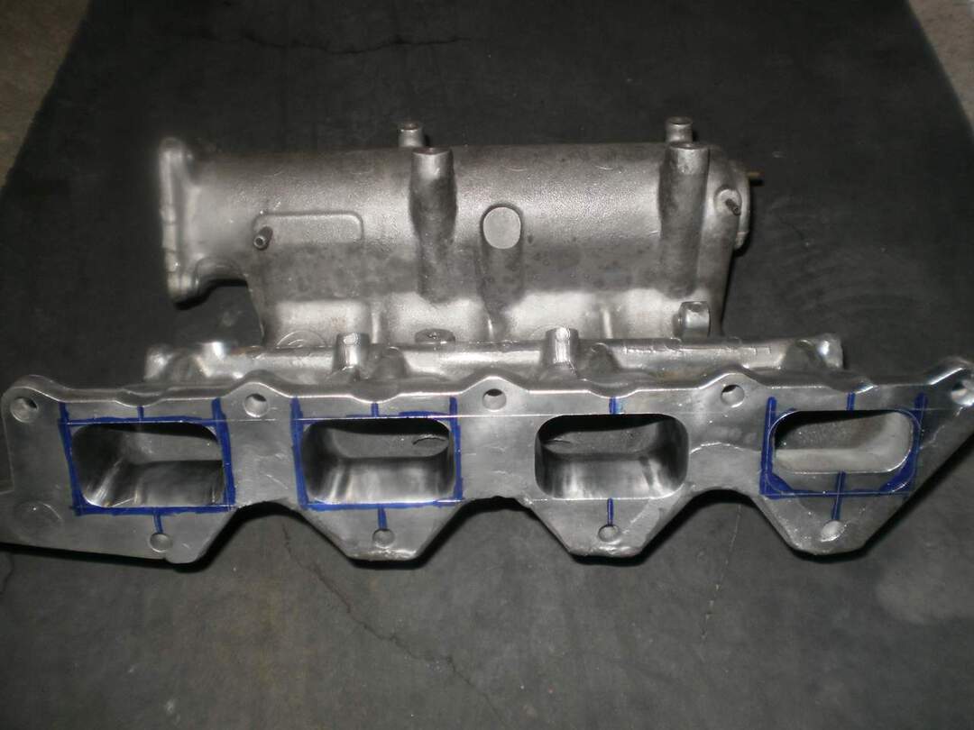

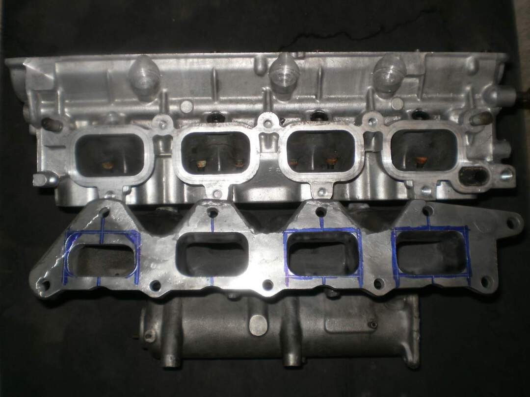

B Series Intake on a 4G9X ....adaptor flange
Bro, on ur adapter tu, u drill the hole slightly bigger to commonize both the 4G9X and Bseries bottom screw hole...
Do u still need to enlarge the hole of the manifold..?
Nice... Good work...
T.q bro,this post i hope u(open this tred) and all frenz not mind coz its out from topic....sory:adore:
but just want to share the same tecnical i do fabricate B.series last post...this intake all frenz know came from EV3.my frenz want me to fit into VR4 head...small hole intake to big hole intake vr4 head. ..so i reweald all bottom flange and port its back to spec...make 4 new hole for extra injector/custom feul rail/externer pot for 2 boost sensor switch(he plan to put inside cabin).....my all frez here cant make some discussion pros and con about....intake runner,plenum cheamber size,T.B size,air flow etc la about intake sistem...coz for me intake design one of major point to help increase HP and respons for revving engine..how to get plenty of mass air flow into cilinder?..hope cant share your espireance and knowledge...thanks

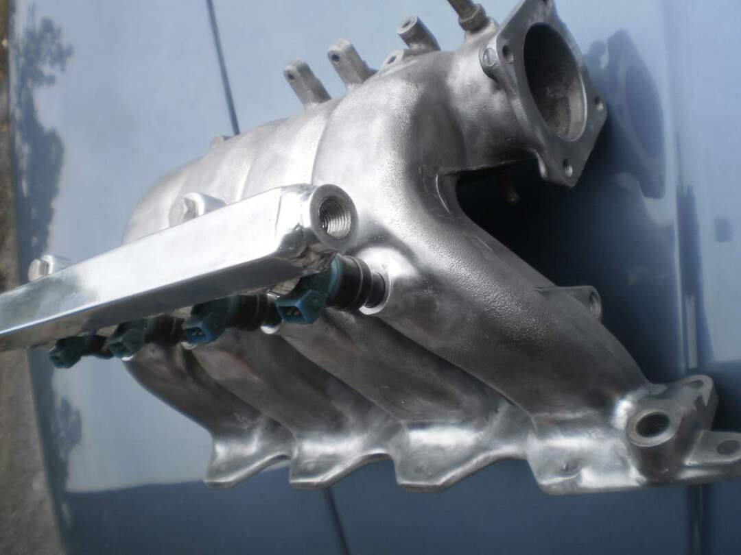

Hi frenz..just to share my Diy :stupid:b series intake can fit to 91,92,93 single or doch head.Mivec also can la.i'v make alot to my frenz..juz want to share Diy...all circle hole must reweld back coz not realy match,specialy hole 1&4.than match port with gasket head la...then recut and some must topup weld to make the flange same like gasket use than port for look like ori.drill stud hole,skiming flange face.the last is to make munt for acesory like coil,sensor,cable,T.B(match port) etc. i prefer to use feul rail B series back..want to look cun use from EG.than polish until shine...but if u use 93 injector.the rubber injector oil ring at B series must port coz to fit...to make like this more coz la..but good match port and look like ori fit....but if my frenz want look more ori..then i make like this red wira terus dia puas hati:hmmmm:

Me to.Kept the Honda's fuel rail, just had to modify the fuel supply line for it to fit the fuel rail. As my intake was not cut, additional holes were drilled so it can be fitted into my head,(engine head.. haha) and had to cut of some over hang from the intake.. Now only wondering is it worth it to source for a bigger TB, as what i can see my current TB is 50mm (original 91) and the intake inlet is 62mm..Will there be a noticeable difference? But what i like the most is the fuel consumption.. rm20 of Petronas RON97,..100km++ and more power!!
