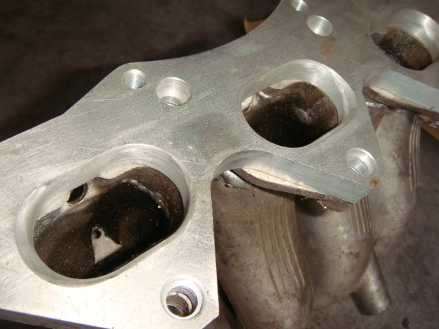

Just collected my b16a intake manifold which was welded to a 4g93 IM flange (spare one i have lying about). The weld quality is good and the inside parts where the weld connection is are all smooth, probably needs a bit of polish to satisfy the perfectionist. To top it of, it was sand blasted so it looks heaps better than when i dropped it off
If anyone wished to do this mod i.e. don't know of any foreman capable of doing this, i can intro you

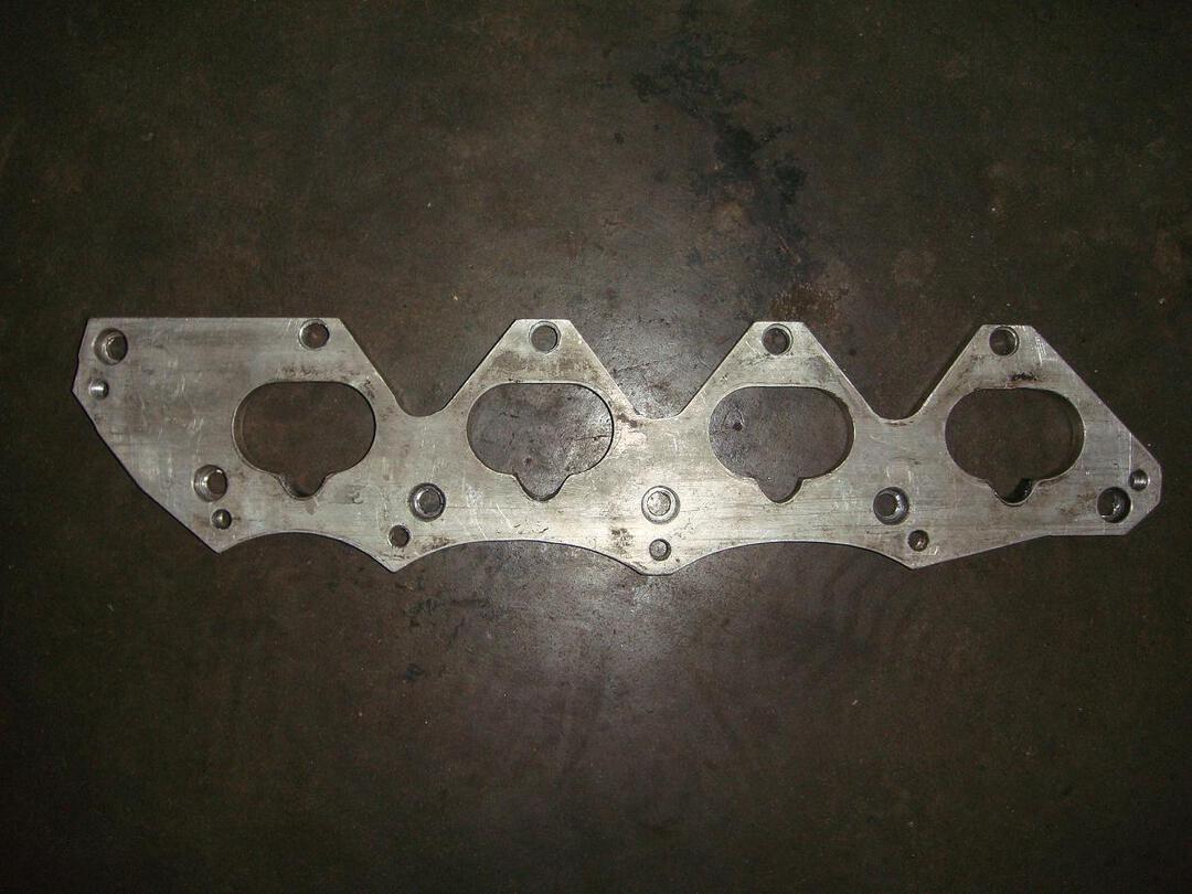

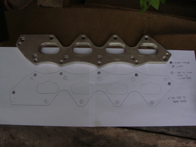

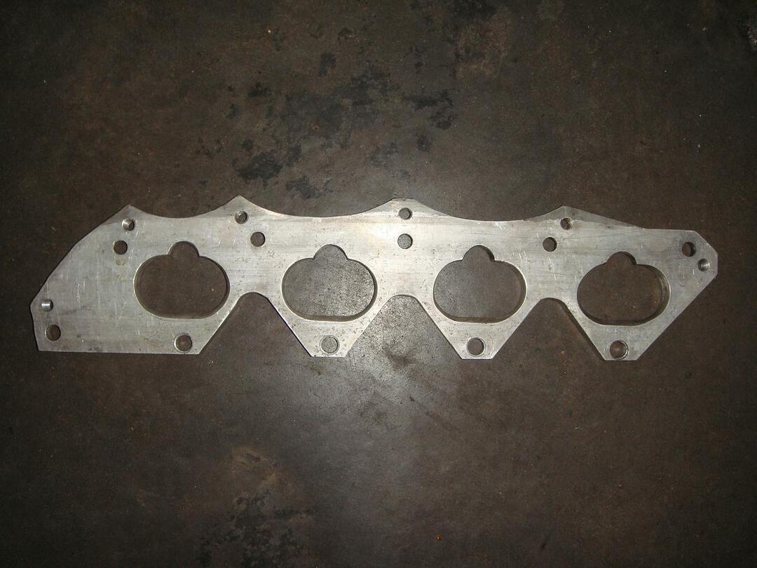

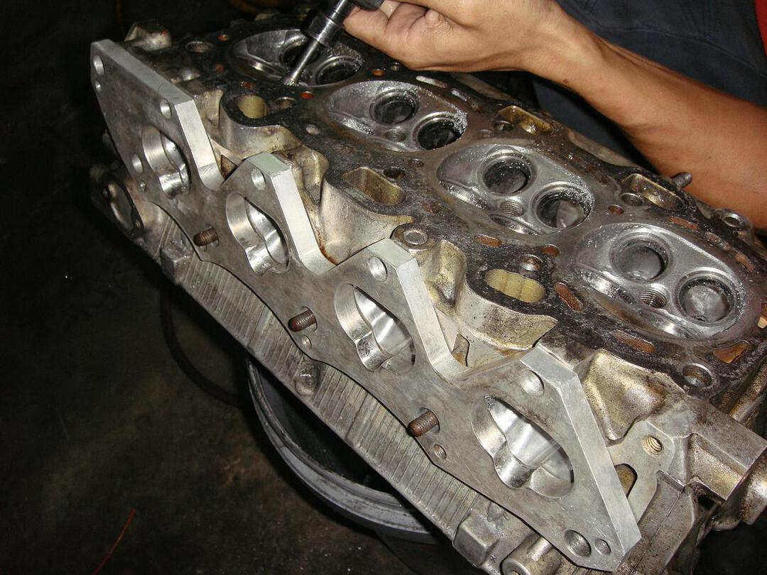

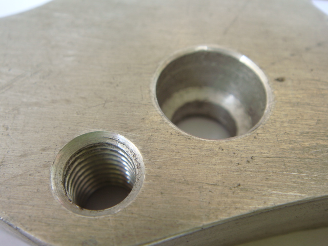

.Hi frenz..just to share my Diy :stupid:b series intake can fit to 91,92,93 single or doch head.Mivec also can la.i'v make alot to my frenz..juz want to share Diy...all circle hole must reweld back coz not realy match,specialy hole 1&4.than match port with gasket head la...then recut and some must topup weld to make the flange same like gasket use than port for look like ori.drill stud hole,skiming flange face.the last is to make munt for acesory like coil,sensor,cable,T.B(match port) etc. i prefer to use feul rail B series back..want to look cun use from EG.than polish until shine...but if u use 93 injector.the rubber injector oil ring at B series must port coz to fit...to make like this more coz la..but good match port and look like ori fit....but if my frenz want look more ori..then i make like this red wira terus dia puas hati:hmmmm:
