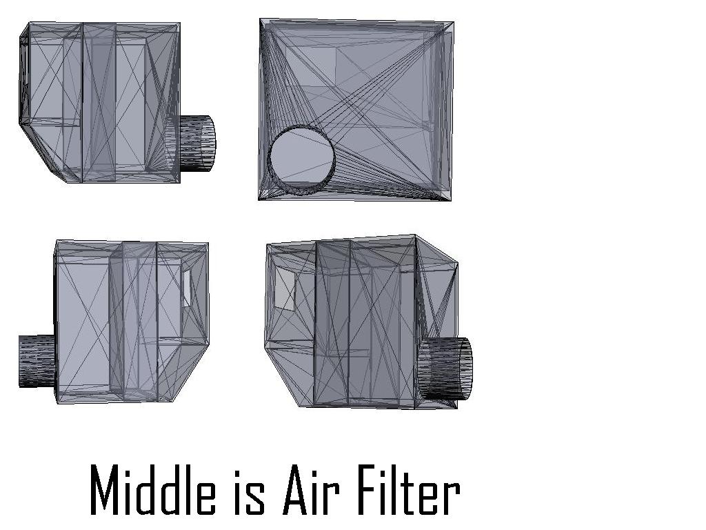

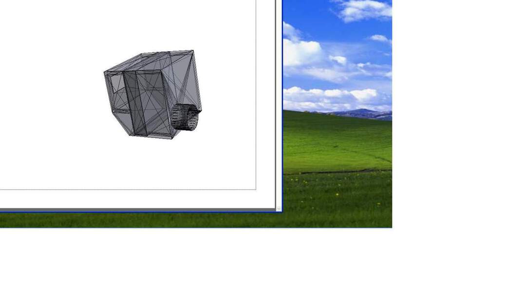

attached in sketch drawing of own version
please help give idea...filter goin to use K&N to replace ARC
material still thinking

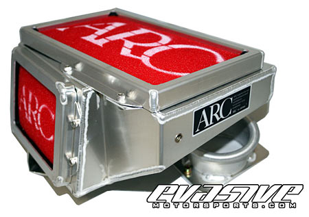

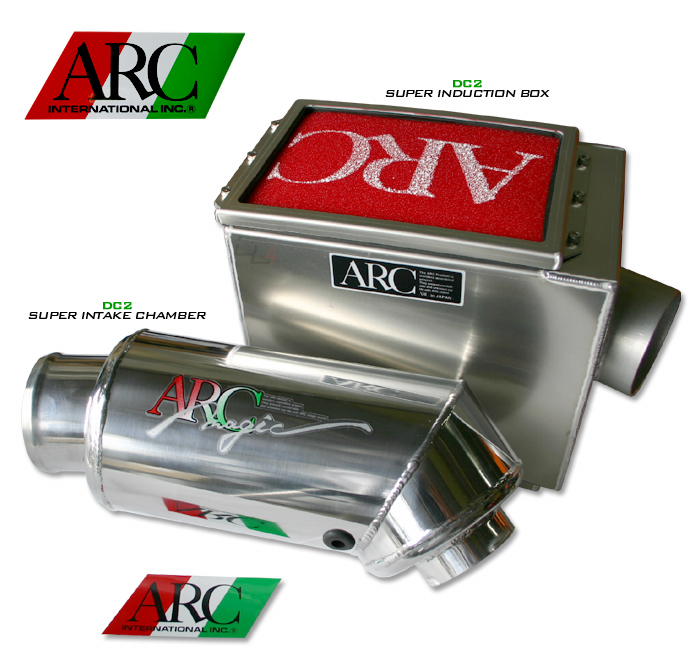

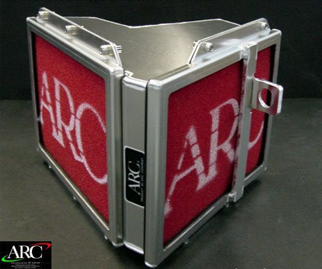

its still in testing stage...due to my car still in spraying i dun have my car to measure the location of the filter box...all drawn out based on K&N dimension...still thinking what type of material suitable for the outer frame...or perhaps u can choose which design is better for 4G93 NA engine...
attached picture for ur suggestion
cheaper is better:burnout:

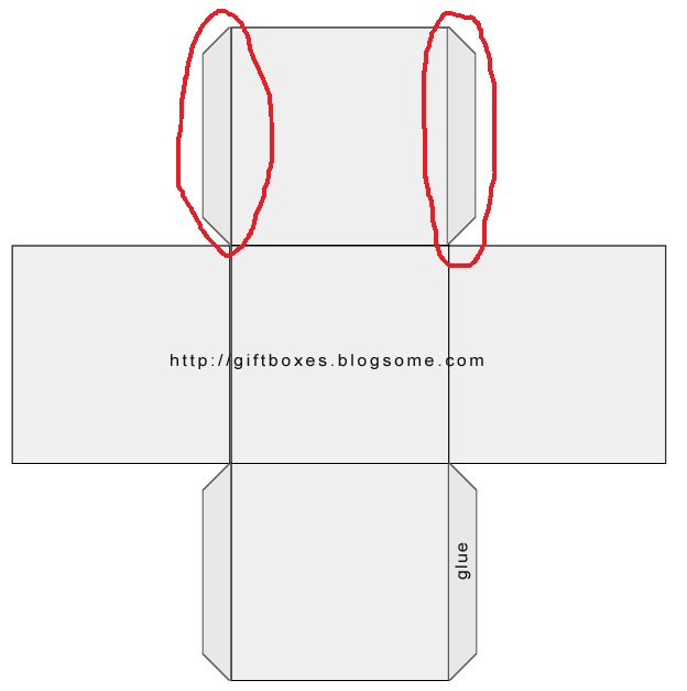

hi there, i was also planning to do the same type of arc induction box during my sem break.. the type of material that i was planning to use was aluminium(haven't decided on wat size yet).
method of doing it:
1)first method:i was planning on making a template out of card board first with all the mounting holes indicated then cut the corresponding pieces out of aluminium sort of like a jig saw puzzle, take the pieces to a nearby exhaust shop that does intercooler piping and have them weld it together...
2)second method: using the same template, open it up till i get a single flat piece. transfer the template onto a sheet of aluminium and cut it out. i had two ways of putting it together:
a)first is the same as the above; have them weld up all the joints..
b)other way was to actually to have extended sides(circled in the example pic attached)-not sure what the proper term for it..:stupid: ... drill holes on those extended sides and to its corresponding sides to be attached with and rivet it... then take it to the exhaust shop to have the edges welded for proper seal...
then have a 3" hole cut out and an aluminium pipe of desired length welded on.. and mount it at desired position
bt my only question is in the design there seems to be only one hole, so i'll be assuming the hole is connected to the MAF sensor via a short length of flexi hose.. but where will the air be sucked in. i can see a square at the front so i'll be assuming that where the air comes in. just to share with you(hope you dont mind :hmmmm:) my design in mind was to DIY a custom headlight out of fiberglass with a projector lamp on the right side(drivers side headlight; towards the grill side for wira,putra,satri) and a CAI funnel next to it connected directly to the airbox.. the airbox will be placed where the battery was (moved mine to the trunk)...
this is just my 2 cents... hope u dont mind me sharing:biggrin::burnout:

great idea...i'll break out the drawing and will build a prototype using acrylic by pasting all the break out portion...air funnel will have to use back original location 1st...

bro...i designed the air intake area on the bottom and the intake to airflow is on the upper section...to prevent water direct sucked to engine but dunno will this effect the smooth flow of the air flows to engine...
