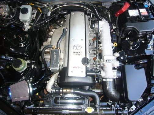

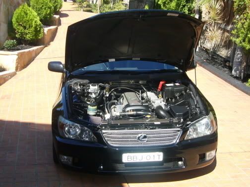

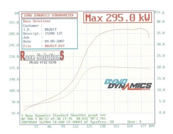

Riz-R...
there r different between AT and MT engines... AT gives max 200hp and MT gives 210hp...
visual different is the intake cam profile...
others like valves material and differential gear ratio...
so if u do swap the tranny but u wont feel the ori MT "kick" except u swap the engine together...
this engine has potential but it is juz too expensive to squeeze it out... the most economical way to "own" the power u dream for is swap with toy chaser JZX100 1JZGTE VVT-i engine with manual tranny... and it is much more easier and cheaper to squeeze more hp and torque out of it... the swap is also pretty direct which swap together with cross-member... all bolt direct... altezza body also allows u to bolt direct with supra 6sp MT tranny... :-)
