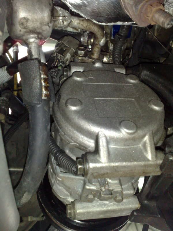

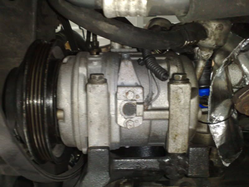

Toyota Altis compressors are piston driven (last longer apparently) and can fit with minor mod.

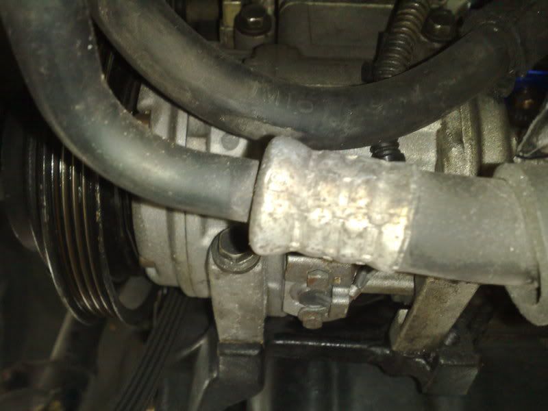

1) Welding one additional hole to fit the lower leg (near the extractor)
2) Plumbing rerouting a bit

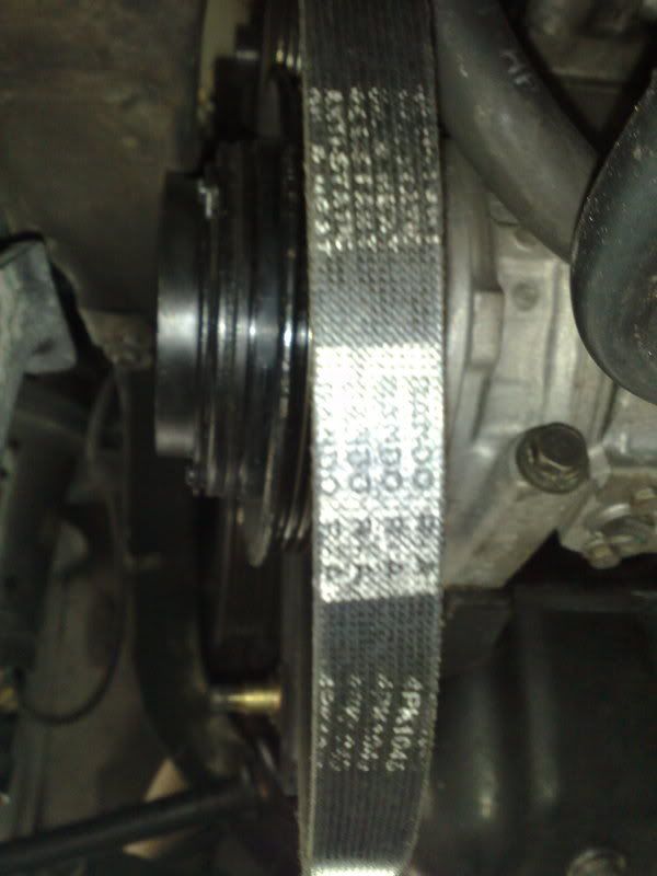

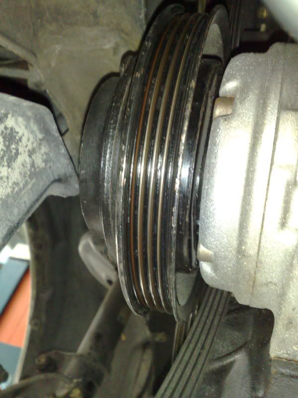

3) Use smaller belt
So far using it it's ok..A/C and Econ no prob..but i noticed that the idle when Econ a little low..so i'll update when i have the time to check why..
I'm not sure which model is this from. Can someone take a few pics of an Altis both 1.6 and 1.8 (1ZZ-FE) to see which engine is it from? The fellows very smart..they torn out the labels..

20V Trumpeteer: Gas all the same. Just switching from rotary to piston and minor welding at the alluminium pipe and the bottom bracket as pics shown. Some ppl say piston cannot tahan high rev. well, I'd rather pay to have a 3-5 yrs old compressor which is piston then a 10-15yrs old rotary compressor. So far this piston type have served me well for the past 3yrs. Just remember to push ur A/C button off when your high revving. It was a habit of mine to do it anyway and I did it to the rotary but still every year change one comp..didn't see the purpose of that.
