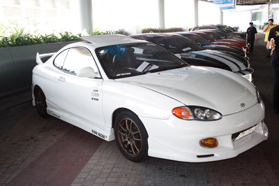

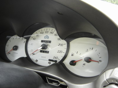

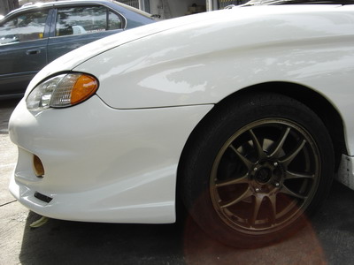

Hi guys!,I'm Po from thailand.I found your site while searching a new idea of my body part so that why I'm here!..I see your new and old model as I had(RD1).
Now!,Here is just regenarated hyundai brand again and I see the new coupe 2007 quite expensive and less optional.My car had modified about body part and changed the console of RD2 instead of my old one! even my sun roof as well.Most of my parts come from singapore and US(as my altezza tails lamp)for my wheels from W-Work company,Xenon light...Anyway,If u guys want to know anything about my car pls. let's me know..
thanks

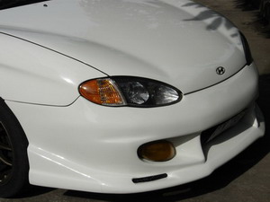

Po,
how you DIY your smoked headlamps?
Mind to share it with me?
I'm interested to have mine done like that too.:burnout:

Would you like to know the secret? :listen:...Give me money!...Eiei..just kidding!
First of all you need the crafts in this project!
1.Heater Brower
2.Flat and Box Screwdriver
3.Grove
4.Flat black spray
5.Silicon
6.You intention and time!
First step!,Screw out your headlamp with box screwdriver it's 4 nuts in each head lamp!and pull the 2 stanlesses lock out
Second,wearing the grove to protect your hands,then uses the heater brower and brows around the headlamp between the grass and plastic afterthat use the flat screwdriver seperates a glass and plastic.(Beware when you seperated)
Third,When you seperated them.It's the perfectly time to clean up your lamps(Glasses) cause it's a lot of dust inside!
Fourth,Uses a flat spray to the chrome(I recommend you to use a tape line down some part of the chrome that you don't want to get its black)
Fifth,After the chrome has dried.Made the grass and plastic together by brows the heater brower to the silicon and try to put them together and keep the stanless lock back!(This time if you're worry about the water,Keep more silicon around the headlamp again).Finally keep its back and Let's show your DIY :love:
