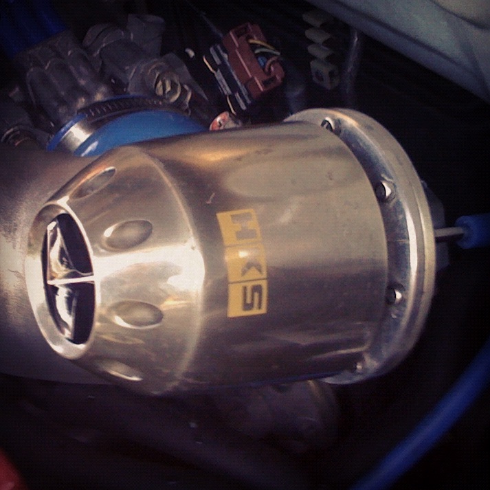

I am not sure which model of SSQV I am using. I am guessing either 2 or 3? Here is a picture. It comes together with the original HKS intercooler piping.
that is Type-I 2nd edition where the logo is just the emblem.. This one also got two models, one with adjustable spring rate screw and the updated one without..
Type-I 1st edition has the Super SQV lettering instead of the HKS emblem.. Type-II onwards has the fins on the sides..

btw, got my ATR yesterday evening... got myself a used HKS Type-I 1st edition SSQV that already had an adapter for EVOVII, so it was a 10mins plug-n-play job.. haha... also got myself an HKS Direct Bright Boost Meter... haven't installed yet, maybe later after work...
will post pics soon.... :biggrin:
so.... this is my third day with my Airtrek... these are the mods so far..
1) HKS SSQV Type-I 1st edition - RM450 (used)
- So far so good... no compressor surge, no boost leak.. and the most important, no stalling.. i guess with an auto tranny, it does not really affect performance... with manual tranny, i think u would definitely feel the stalling while shifting...
