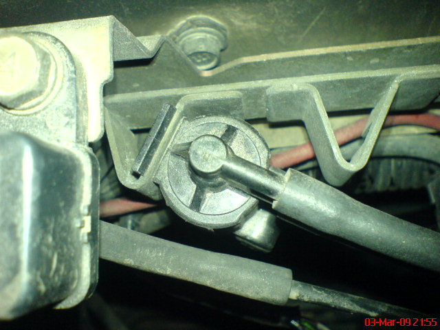

Hi bro,... can show where is the location of the by pass valve locate in the engine bay??
better attach with photo... then easy for us to DIY check & clean up or replace new 1.
:adore::biggrin:Thank you..
pls look at the pic... is it this 1 ka??? pls advice??

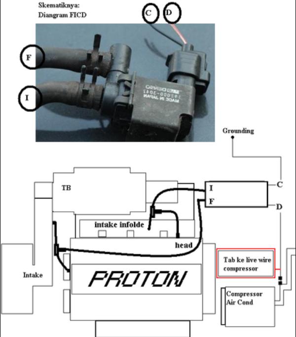

According to ur explanation.... I think I done it, cos I added the FICD front toyota into my wira same like u said.
Below pic for ur reference....:driver:
i am not quite sure where is it.... but then u can try to find a hose that is attached to somewhere after air filter and before trottle body, and the hose will attach to a device that should not be quite big... then the device will have another hose that will attach to you manafoil.... AND please be gentle to me..... i am not your BRO.....

alright.... no worry..... that is what i am toking about... i dont know what is it called.... hahaha... so i call it a air by pass valve.... which allows u bypass air before your trottle into you manifoil...
ya,... FICD (Fast Idle Control Device) it help a lot..!! I am using it on my wira.
But it might be my wira oem FICD not working properly....... better check on that too.
