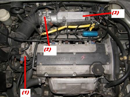

ignition coil that connect the plug wires to the spark plugs. How serious is the jerk? Is hard to indentify the probs with the speed of 90-110, test the coil by this way, drive 2nd or 3rd gear 2000rpm than suddenly step it all down (full throttle).
is not the speed related, it is rpm related. as i told before, any any speed or any gear, around 3000rpm, the jerking happens. can i know the coil is the problem by just looking at it? can you give some photo of the coil?

Picture below no.1 is ignition coil. Coil faulty is unvisible outside only the worse i heard is getting melt :smokin:
nothing unusual i guess. but i can try, rev at 3000rpm and see how it behaves.
owh, that one we call coil. two screws holding it to the engine right? one hole has screw and the other one doesnt, just uses some sort of clip because the previous screw snapped and stuck inside, cannot put a new screw. Is that can be the cause? maybe because it is not fixed properly on one side, has some gap
