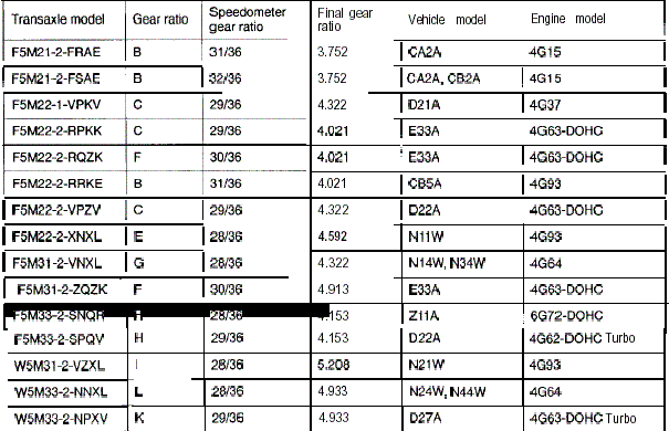

Hi to all,
I'm just wondering if this is the right gearbox code for 4G92 Mivec. I do believe the code is unique but...need you guys to advice on this,
This is what i got,
F5M222RRKE
VC8520
I'm in da midst of engine transplant and all, just to ensure the workshop guy putting the correct one as I'm intended to put LSD in the future, does this gb support?or is this the right one?
Just to avoid from getting conned! hehe ;-)

Modesto: google F5M222RRKE and i found this.
and this:
CA4A Boxes (1991 -1994/5)
F5M22-2-????Code:
XRZE (MD970428)
XRXE (MD971902)
XREE (MD971904)
Code:
XRWE (LSD) (MD970429)
XRGE (LSD) (MD971903)
and the direct link: http://www.mivec.co.nz/forums/viewtopic.php?f=34&t=4275
Hi Yee,
Cheers for the info and the pic,
Very well great indeed!! :wavey:
me code is:F5M222-RRKE
this gb not with LSD but, im tend to fix the LSD in the future,
just need to know if this is compatible?
also the pomen said this is 4g93 1.8 gb! but does it go along with 4g92 1.6 mivec?
will i get the top speed and pick up?
cheers:driver:
http://www.zerotohundred.com/newforums/members/modesto007.html: yeah the 1.8 gb is compatible with ur mivec engine, cos it's from the same- 4G9x series family. Besides, i believe there are some after market LSD available for sale(try to ask around) in kl. Mivec gb has a shorter ratio (good in acceleration) while 4g93 gb has longer ratio(higher top speed).
