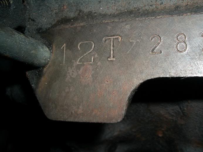

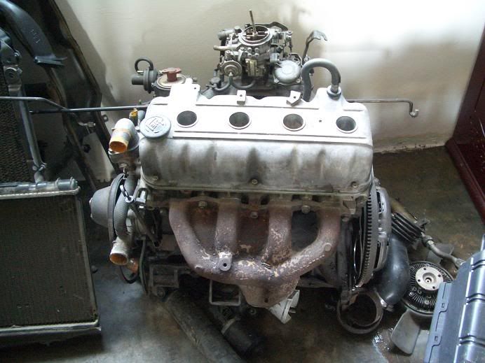

Me dunno shitz about Toyota, I can't help but notice you guys talking about 2T engine.
Is this a 2t engine?
I took picture of the block no as well.
So is this 2T or 12T or wat engine?
Me still learning about all this TOyota engines. THanks.
Joeker that is one of the generations of T series engines. That is a 12T that u posted. But strangely the engine cover is same as my 2T-B. But i remember seeing many 12T using slightly different cover especially the re routed oil return. 12th generation T block engine.
