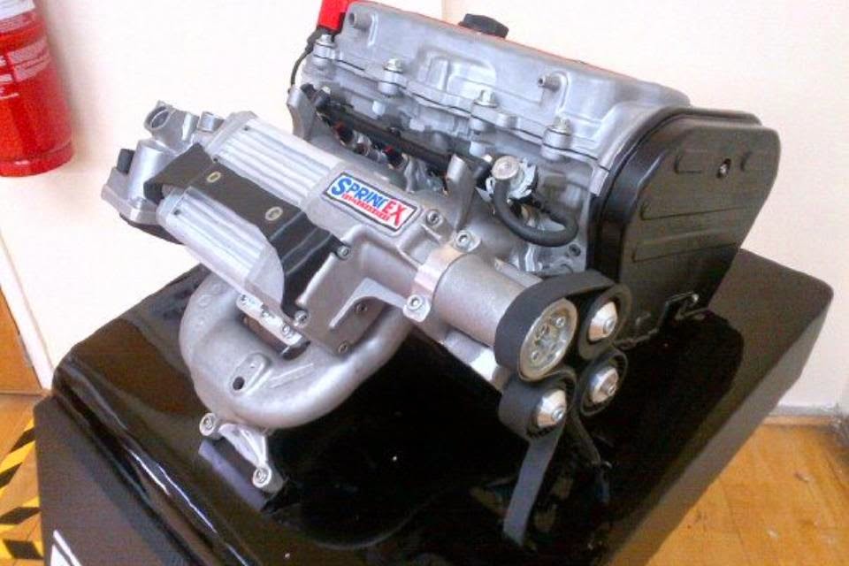

Hi everyone,
Does anybody here have any experience / advice / review on putting in a supercharger (most likely a Sprintex plug-and-play Supercharger) for the Campro CPS? I've been seeing a few on Proreka's page, just wondering what the long-term use would be like under daily usage. Much thanks to anyone that can share their views or 2 cents.

consult the dealers..then do some study on how to cool compressed air ( if you've decided to install the kit )
Its a nice product.
*side note:
air to air cooling-
pros:
- free
- little maintenance
- efficient enough for daily use
cons:
- requires plumbing works
- takes up space that the Satria Neo is already lacking
chemical cooling-
pros:
- the "juice" used for cooling also has a positive impact to power output
- less space taken up in the engine bay
- ecu controlled
cons:
- requires maintenance ( no juice -> too hot -> meltdown )
- expenses to replenish the juice
Just my humble opinion..
