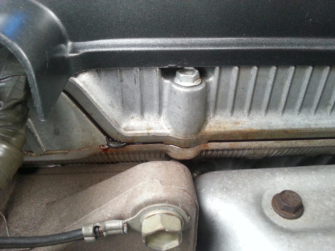

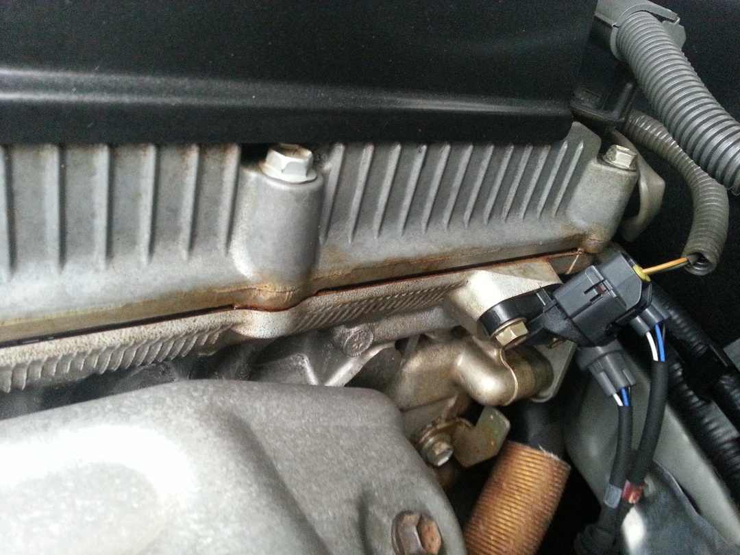

last two days i just go to used car shop see altezza.
and i found some oil leak on the side of engine head.
on the picture can see something like gasket melt. my question is it the engine over heat or normal?
the car running milage about 130000+, the timing also is time to change?
cause i plan to buy the car.
thanks.

Almost impossible for this gasket to melt. It's probably hi temp liquid gasket that was used during its last major overhaul. This engine has certainly been overhauled before.

If the tak-tak sounds goes away after warming up then don't worry, it's just the valve tappet clearances.
However, you may want to worry about the fact that the engine has been overhauled at less than130k km. Means maybe the previous owner didn't really take care of the car.

Replace timing belt is not overhaul.
Overhaul - yes, maybe he did grind the head but maybe he just changed piston rings.... it could have been anything. My point is that car shouldn't have needed an overhaul, unless the driver thrashes it daily or he didnt maintain by not putting in water or changing his oil.

just sharing. i experienced this before. just replace the gasket. the gasket is just rubber anyway.
cant remember how much. but not too expensive.

just now i go to the used car shop again,i touch that thing it feel like rubber.
i also not sure the liquid gasket how it fell like.

Bro... to change the top gasket is not expensive.... check the car for accident. Pls also check underneath for any damage... :rolleyes:
I know it is not expansive.May be rm200-300.
The worry thing is this car have been overhauled before.

that valve seal cover its about RM80 i think...
