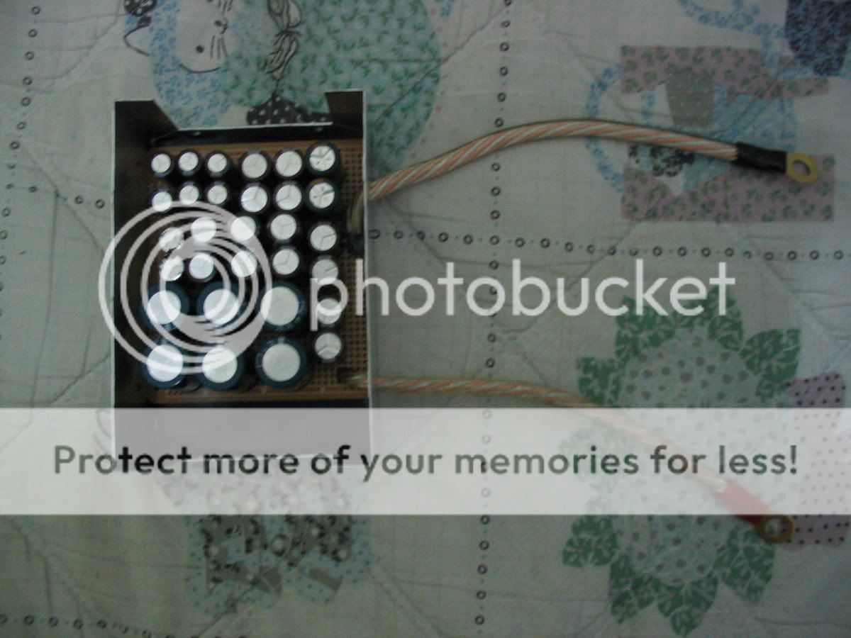

This is cool, but I am not an expert in Car ECU, but if you are you should notice not all cap in ecu are rate 63v; some are 35v, 20v and even 10v cap.
But normally the cap were have 20% tolerance(mean 16.5v were tolerance up to 19.8v) and I use only 3 x 5.5v 1f low ESR supercap to reduce the cost, it's very expensive of these supercap. Properly I may add 1 or 2 supercap to make it 22v or 27.5v but i don't think it necessary.
My VS work fine and I use diode to protect my device and LED to discharge it power when turn off.(Currently I use just normal diode but not TVS diode or avalanche diode )May be I were add on one Zener diode for better protection, after considered your advise. I have to ask my brother in law whether he stock TVS diode or not, he own an electronic component shop in Melaka. But his shop don't stock supercap I order online.

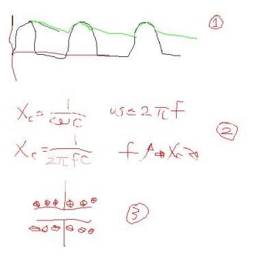

Higher voltage cap or low voltage cap don't affect the capacity of the capacitor;63v 10000uf have same capacity storage as 16v 10000uf. So by connect 4x16v 10000uf cap in series(to 64v then parallel with car 12v source), were be far more less cost then connect 4x63v 10000uf cap in parallel with car 12v source.

Caps have 20% tolerance as a tolerance rating to the Capacitance or uF rating variation. Usually as a factor with temperature, design, etc. As a rule of thumb when designing electronic circuits, caps used has to have at least 30% higher voltage rating than the actual supply.
