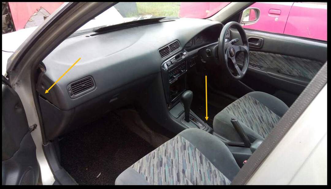

i would like to tumpang this thread and ask.. my SE Limited fit with blacktop 20v ae111 dashboard.. oni problem is whre the dashboard meets the handbrake/arm rest panel cant fit into my Se limited. Is there a way to solve this problem... either to alter n fit the ae111 arm rest... or have to keep the SE limited arm rest?... hope sifus can shed some light....
I think ae101 bt wagon dashboard can fit in our local ae101 nicely (need confirmation)
Coz both of them hv 4 doors n a lot of that hcut coming in now
For SE ltd, u can try that dashboard too :wink:
These gaps is really an eyesore
